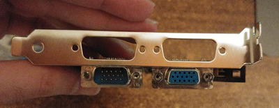

Reply 5 of 9, by Ozzuneoj
In a pinch, if you have any worthless old cards with dual DVI or DVI + VGA, even if it doesn't line up perfectly it will work as long as the bracket sits at the correct height and doesn't prevent the card from slotting in firmly. I did this with an old OAK VGA + EGA card that was missing a bracket. I stole one off of a dead Geforce GT 610, exactly like this one and it worked great: https://www.amazon.com/EVGA-GeForce-mini-HDMI … R/dp/B0083YIGVU

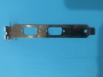

Reply 7 of 9, by Kahenraz
bjwil1991 wrote on 2019-01-09, 16:15:
Test the card first before buying a bracket. If the card works, then you can buy a bracket.
https://www.keyelco.com/product.cfm/product_i … 88/checkStock/1 is the bracket.
This is not the right bracket. The wholes are too large and are oriented upsidedown compared to the original bracket.

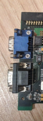

Reply 9 of 9, by Nabors
Datadrainer wrote on 2022-01-12, 18:01:
On the website linked by @Kahenraz there is also a bracket for DB9 plugs, which is the same size as VGA plugs. Maybe it can suit the Voodoo² [https://www.keyelco.com/product.cfm/product_id/2490].
That bracket is has the plugs in the center of the bracket My Diamond Monster 2 is offset to the outside of the case.
