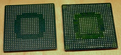

Reply 10 of 49, by Kizmo
VSA-100 Chips arrived from china, things are looking good! Left is what i got from china and right is the old damaged chip.
The attachment frontside-small.jpg is no longer available
The attachment backside-small.jpg is no longer available
Links to hi-res pics:
https://www.dropbox.com/s/g07a1xk4c1xzwa3/frontside.jpg?dl=0
https://www.dropbox.com/s/0gdz63obmmv20r0/backside.jpg?dl=0
Next step is to repair the pcb, there are traces that need some love. Sadly my UV cure solder mask resin was expired so we need to wait for new syringe to arrive.

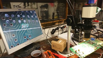

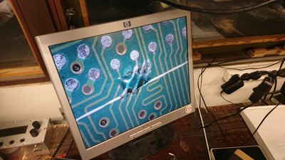

Progress!
PCB surgery is now finally done.
The attachment start.jpg is no longer available
This is how it looked after the part one. Screw driver damage.
The attachment masked.jpg is no longer available
Masked, scraped, tinned. Using leaded solder and Louis Rossmann approved amount of flux.
The attachment all done.jpg is no longer available
All done, little bit of UV cure resin will hold these repairs in place during reflow. It is very important not to encapsulate repairs like this completely since the solder will melt and expand during the BGA reflow. I have learned that the hard way 🤣
The wire i used was little bit on the large side but the repair should clear the BGA chip ok... i hope. We will find out tomorrow.
