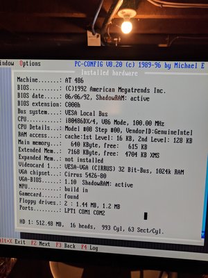

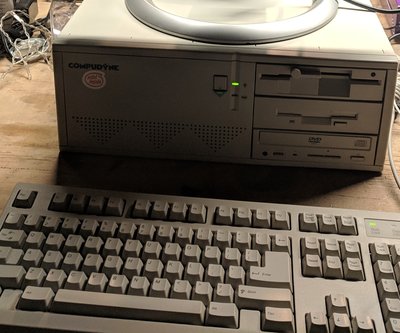

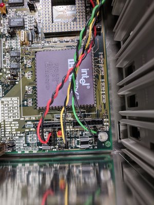

I don't see these often, and saw one that externally, looked good. Had no idea of what was in the inside. Was told it powered on and 2 beeps, which I was guessing was a memory error. The previous owner didn't even have a VGA monitor to hook up to it. For a early 90s case, I liked these desktops ATs.
I got it in the original box, with original keyboard, DOS 6.0 Compudyne 5.25" Floppies, Compudyne Monitor Manual. STB Horizon VLB Manual and Drivers disks, 5.25" as well for DOS and Windows 3.1. Came with the all-in-one multi cpu manual, looks like UTD or Up To Date Technologies, LLC on the board. Also have the original tech test sheet, and the purchase order receipt, $1700. Came with a Serial Mouse, don't know if it is generic or Compudyne, no markings really.

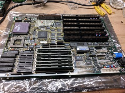

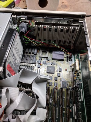

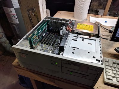

So I got it, opened up the case and was blown away how clean it was inside. Almost no dust, very shiny, a pea sized spot of corrosion on the PSU chrome lid. This thing I swear looked new. I saw these new back in the day and you could fool me with this system.

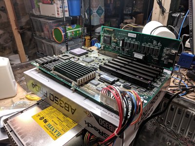

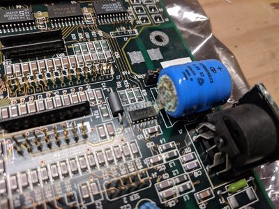

Has the soldered on battery so I went ahead and removed that as it was leaking. I cleaned the board with alcohol as one chip looked damaged. That didn't remove the corrosion, so I used vinegar with a dropper, let it sit for a bit then when and sucked that out, then used alcohol to clean it again a few times, blew it try with compressed air. Under that chip some of the fluid went and out it came. Anyone have advice for how to clean the board of any stray vinegar I may have spread where I didn't want to? I just doused it with alcohol a few times, use a tooth brush to gently scrub and blew it all out with compressed air.

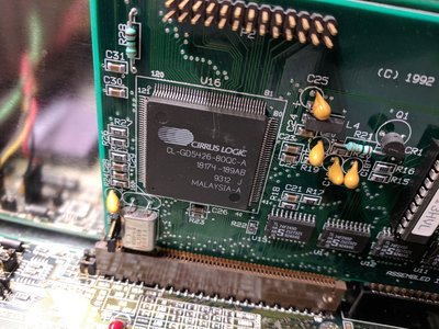

So I hooked up the PSU after I was sure the board was dry, to bench test, installed the VLB card, and powered it on. Got life and the expected CMOS error, the 2 beeps were that message!
Shut it all down, put it all back in the case, seriously all was super clean! Booted up again, went in the CMOS to set the date, floppies and HD and it booted to Windows 3.1! Dropped out to DOS and looking at files the system was last used in 1996 and booted at least once in 1998 based on the only few files that are chk have a 1998 date.

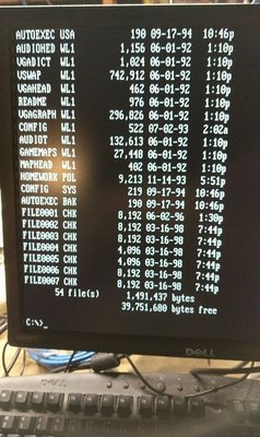

Did a scandisk, no bad sectors. 3.5" floppy works great, 5.25" Looked good but I had some problems with 5.25" floppies, so don't know if it is the floppies or the drive slowly going.
So I have a few questions on the system if anyone can help. Looks like it was never upgraded, just the VLB CL GD5xxx card with 1MB, HD is Maxtor 240MB, 128K Cache and 8MB RAM.
- I don't know if these came with spare rails for the 3rd bay, I want to add a CDROM drive. I think they are standard AT Rails, but I can't find them anywhere.

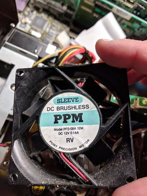

- Noticed the system was getting hot, and saw the PSU fan was no really moving, opened the PSU and confirmed, super clean inside!
- Are all 30pin SIMMs the same, other than capacity? Might as will put the max in this, 32MB.
- What about Cache upgrade memory
- The 386 socket is of course empty, but why does the 486 socket the CPU in have extra empty holes in the socket? Is this for Cyrix or other CPUs? Manual is not clear on this.
- I got a 2.6v lithium battery to mount external, this board has the header. Other than disabling the internal battery that is now gone, do I just plug in and go?
- Will ask the vinegar question again in case it is missed from above, just clean with alcohol properly?
Thanks!

Reply 3 of 15, by SirNickity
If you think you've flushed out the vinegar with the alcohol, you should be OK. I usually just rinse the board in water afterward. Thoughts on that vary, but I live in a dry climate with good water quality, so it's pretty easy to dry the board thoroughly, and I don't really need to worry about mineral deposits.
My advice is to check on it regularly. Maybe pop the hood in a week, then a month, then a couple months, then next year. Some people have had issues with corrosion "coming back", if it didn't get cleaned well enough. Be vigilant and catch any relapses before it causes damage. Other than that, just enjoy it. 😀
That's a nice find. As much as well all love to customize and tweak our rigs, there's something special about finding a pristine OG specimen out there in the wild.

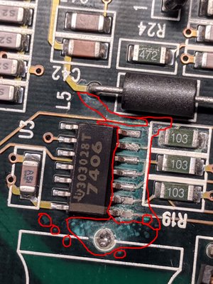

Reply 5 of 15, by Keatah
Lovely rig, no doubt.
But I don't believe you've flushed all the acid out. Not if you can plainly SEE it in the pics. Something like this needs some localized scrubbing and then neutralization. Also the solder should be reflowed. Traces checked, sanded, coated/replaced, and then sealed again.
The acid migrates over time and continues to spread if not removed. The damage right now looks easily fixable, but in time things that are silver, will turn grey. And that surface acid will eventually make its way into the PCB layers. More work needs to be done. I speak from direct experience on this.
CMOS stuff is rather sensitive and hi-impedance. This means that the slightest trace of acid can generate current when in contact with metals.
I just repaired a board where a drop of acid so small as to be seen only under a microscope at angle was generating power between ground and PWRGOOD and PSRSTB#. Improper voltage levels/signals here cause the RTC in the 82C206 to not cleanly take itself in and out of circuit properly. And to not cleanly reset ether.
So this causes high current draw if the 82C206 stays in-circuit, leaking power to the rest of the mainboard address lines. Or it could corrupt several registers as the system transitions between power-on and power-off. Especially if the signal is in-between what it's supposed to be. The chip and stay half-in and half-out of circuit.
Granted this is specific to my board, but the concept applies to acid and metal and CMOS all exhibiting erratic operation due to stray currents in the uA or less range.
Some circuits are never affected by this because they need mA range current and several volts to trigger. No so with high-impedance CMOS inputs.
Reply 6 of 15, by Keatah
I marked the areas that look like remaining acid deposits. And what's under the chip?
If the bright splotches will not come off, they may be on the inside of the board. If a bright piece of the board is nicked with a pin in the suspect area, a bright speck of lamination may crack off, reveling corrosion underneath.
Or the acid may have been concentrated enough to attack from the top, but not making it all the way through. Best case! Seen both conditions.
The topmost surface usually turns green where it broke free of the underlying copper and now reflects light differently. So.. Using specialized tools, a neutralizing agent can be injected and then flushed. Probably not something for the home hobbyist to do, but the first layer of insulation can be removed, the work done, and then re-coated over. Practice on a scrap board.
l
Other experiments I've done include a quick activation and quick dry accelerant. What else do I call it? Brush it on and it kicks the surface acid into conduction and it generates enough voltage and current to flip gates and make your DMM happy. Lasts about a minute. Once pinpointed, repair can then be done.
A friend of mine simply pours on the flux and solder, brush clean, and repeat, till everything is shiny. The claim here is that the high temps speed up years of slow-acting corrosion into mere minutes or seconds. Burn the stuff away, has a sweet cardboard'y smell most of the times. Seems to work well on some sufaces or vias, but will soften the enamel coating on resistors and tantalum capacitors, which then can eventually re-harden. Which is good.. But IMHO they're now compromised and more susceptible to ambient humidity. Replacement of such parts is usually in order.
I suppose it's a matter of examination and experience that says what technique to use where.
The attachment IMG_20190119_203935markup.jpg is no longer available

-I'm not sure abut this exact case but rails are hard to find for anything after a few years, Your best bet is to get "creative"
-Cooling wasn't even a consideration when these were built, It's probably not needed but cant hurt mounting a fan to increase air flow or add a heat-sink on hot chips.
- RAM also has different speed measured in ns on the chip 80ns is fine for a 486 with 30 pin ram
- Yes the extra holes are for different CPU's Nothing to worry about.
- You may have to set a jumper to tell the motherboard to use an external battery, after that your good to go.
Reply 8 of 15, by 32bitdx
Thanks for the write up, ok, I will pull the board again and try to clean more, for a n00b like myself trying to clean battery acid from pcb first time ever, what do you suggest I scrub with? What fluid if any should I use?

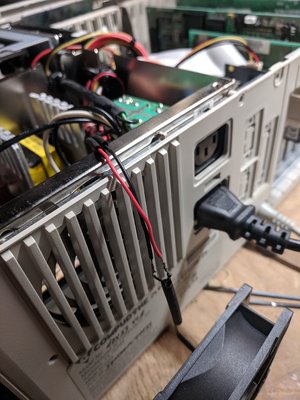

Also fixed the fan on the PSU, realized after the system got super warm, that it was the PSU overheating 😀
Don't worry system was shut off at the powerstrip before working, this was for ease of testing. Fan was soldered on, so had to butt solder, shrink and shrink again.
The attachment IMG_20190128_215541.jpg is no longer available
Old one span, but needed a kickstart to get it moving, oiling it didnt help (even though all the old oil was gone)
The attachment IMG_20190126_222826.jpg is no longer available

These combo boards often re-purpose the 486 socket as a socket for 387 FPU when a 386 CPU is present. Then the inner holes are used instead of the outer ones (387 FPUs are much smaller than 486s), which are for the 486 CPU. If they overlap - well, that's funny but these combo sockets do exist.
