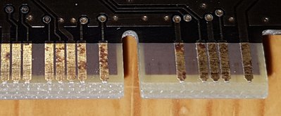

I have a feeling that my audigy 2zx has too much corrosion in its pci connector for it to work properly because in one pci slot it was recognized that it is in the system with yellow mark in device manager but the driver installer didn't recognize that there was audigy 2 zs in the system and when I switched it to another pci slot it was as it isn't in the system at all.
Already tried using deoxit, but it didn't make much difference to the pci connector.
The attachment audigy2zs.jpg is no longer available
I wanted audigy to get eax in games and 48Khz dvd playback in win98, but perhaps SB live would work as well.
