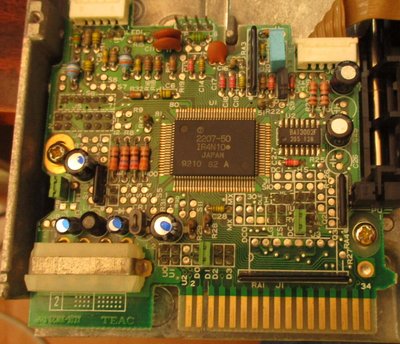

These pictures are from my own TEAC FD-55GFR. The first one is the IR LED for the rotation speed/disk presence detector, and the second is of the resistor terminator pak. The IR detector is underneath the flywheel.

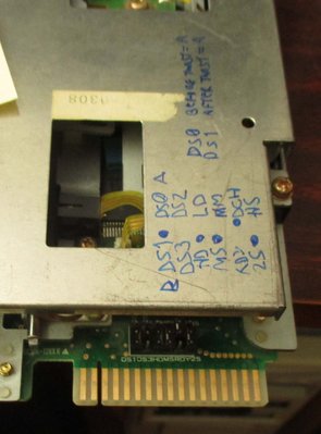

Reply 12 of 12, by Tiido
Today I have been messing around with my drives again and I have managed to get all 3 that I have working : Mitsumi D509V2, NEC FD1157C and Teac FD55GFR.
In the end the problem was combination of dirty cables, corroded jumpers, misconfigured jumpers and possibly some motherboard related things since this time I used a PIII board for testing rather than a 486. I took photos of all the jumper settings so that someone else with such issues may find a solution.
Mitsumi :
149.3 KiB
617 views

Teac :
324.38 KiB
617 views
I'm not actually completely sure what all the jumpers on the NEC drive do, I tried to move some of them during operation and observed no change in behaviour...
NEC drive seems to have most make sense jumpers, they all do exactly what they say. That drive should be fine with 360KeB disks too.
