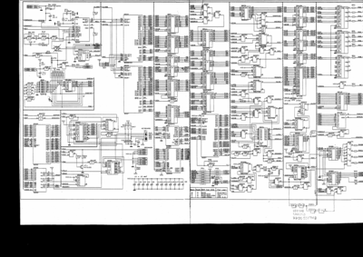

So I've acquired this gem for free a while ago from my local high school (yes, for FREE). It's a XT clone motherboard (XL-7 Turbo), likely pulled out of a bulgarian Pravetz-16 8088 PC.
It was in a really awful state before i got it, somebody aggressively desoldered all of the RAM sockets along with a few other chips. Thankfully, with some patience and some new parts I successfully put it back together... sort of. I am still missing the two PROM chips (see photo, PROM1 and PROM2), it appears to be a PAL16L8ANC from other photos online. AFAIK, these are programmable array logic chips, which unfortunately I didn't get with the motherboard (I have everything else, including the original BIOS EEPROM)
I have tried to test it with spare PAL16L8ANCs (not knowing what they did at that time) but it appeared to be completely dead (no beeps). A debug card didn't help, the POST codes may be sent on 60h instead of 80h ? (just like the IBM 5160). Later, I have attempted to "reverse engineer" the 5160 motherboard in the hope that i could replace the PROMs with TTL logic chips, but that got way over my head.
I've also found a page about this motherboard, but it is in russian, which doesn't really help me, since I don't speak russian: http://www.phantom.sannata.ru/forum/index.php … um_view&o=&st=0
The only other things i know so far is that the reset circuitry works (tested with debug card) and the CPU runs at 4.77MHz and 8MHz (with turbo switch), which I tested using my oscilloscope. Below there is a attachment with a circuit diagram of a very similar XT board from Russia if it helps.
I'm a newbie in the vintage PC world, especially in the XT era, any advice is appreciated.
If anyone can give me help or knows someone who can help me to put this thing back on its wheels, I would be truly grateful.

U31 creates the bus signals from the processor pins.
U42 does the address decoding.
Every one of both is critical.
Without them, no ROM will ever get a CS signal.
The logic is not complicated.
it was described en detail in the Intel and AMD 8086/88 handbooks.
Each one more than 1000 pages.

Reply 5 of 26, by retardware
@computerguy
I don't understand the purpose of the table you did with the multimeter. The schematic tells it all.
What you need, respective have to create is a set of truth tables, which needs intense consultation of the according hardware manuals and data sheets.
If you don't know what a truth table is, I'd suggest you to put away the mobo until you found somebody else with a working board, try to read the PLA using a PAL programmer, hoping the readout fuse hasn't been blown. If the latter is the case, there is no way around creating truth tables.
More than 30 years ago I had a similar challenge, finding out the logic in the C64 82S100 PLA that liked to get ultra hot and to die, and that took some time.
So I again say, this is a thing that is a manageable challenge if you have skill and experience with logic.
Edit: Just proactively I'd like to say you that I didn't look intensely enough at the schematic to say for sure whether powering up the board without the correct PALs is safe. In particular there is the risk of multiple tristate outputs mutually shorting out. Officially the buffers usually can sustain such, but the reality shows that this can cause damage.

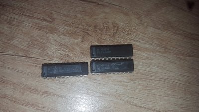

Reply 11 of 26, by computerguy08
FIRST SIGNS OF LIFE :
227.73 KiB
681 views
I could never thank enough to the russian people at phantom.sannata.ru for showing me the nail in the coffin, one of the ICs had to be a PAL16R6ANC (register array) and the other one a PAL16L8ANC(logic array).
170.8 KiB
681 views
Next step is to see if I can get some sort of video output out of any of my VGA ISA cards.
