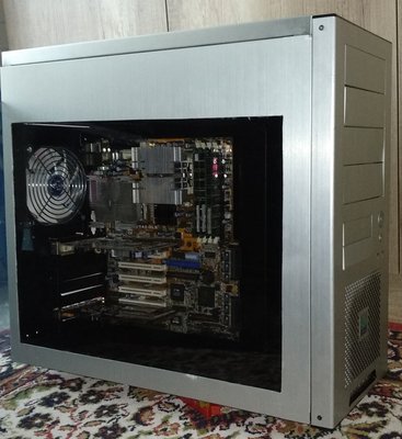

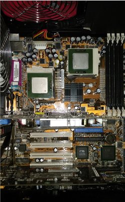

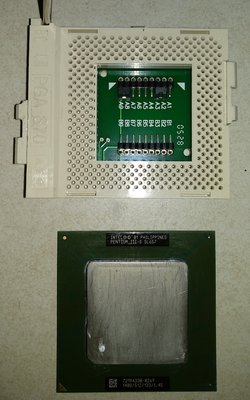

After years searching this specific hardware, I finally got an ASUS CUV4X-DLS Dual s370 socket , 2x Lin-Lin adapters , 2 x PIII-S 1.4GHz Tualatin and 2 x Aftermarket Heatsinks, all at 50 Euros!

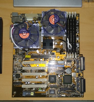

The Rig for testing has:
ASUS CUV4X-DLS (Dual socket s370, Ethernet , SCSI adapter)
2 x Pentium III-S 1.4GHz Tualatin (1400/512/134)
1GB RAM (4 x 256MB PC133)
ATI X1650PRO 256 MB DDR3
Creative Audigy
Windows 7 32bit
Waiting for 2GB RAM (4x512MB PC133) , an PCI to SATA adapter to connect an 120GB SSD, 2 x Waterblocks to watercool the CPU's and a new windowed case.

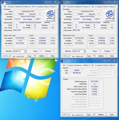

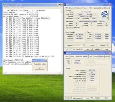

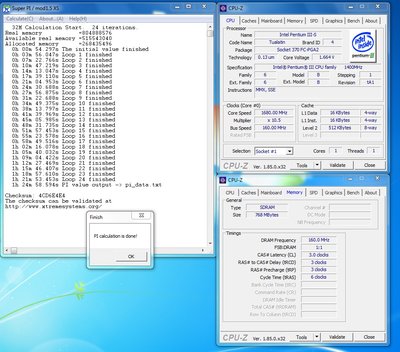

Reply 1 of 31, by Obijuan1983
Windows 7 32bit

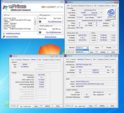

2 x Pentium III-S 1.4GHz @ 1.625GHz (Lin-Lin adapters voltage 1.6v )
1GB RAM
411.6 KiB
1518 views
SPi1M @ 1.625GHz
437.86 KiB
1518 views
Windows XP Home (SMP not supported)
SPi1M
PIII-S @ 1.625GHz, Memory @ 155MHz 2-2-2-6
293.14 KiB
1514 views

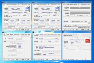

Reply 7 of 31, by Obijuan1983

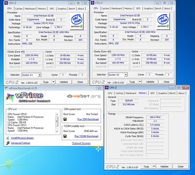

2 x Pentium III-S 1.4 @ 1.68GHz ( Full Stable )
wPrime 1024M
271.02 KiB
1319 views
And for comparison
2 x Pentium III EB 1.0GHz @ 1.2GHz
wPrime 1024M
276.93 KiB
1309 views

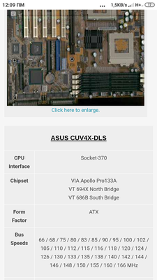

Reply 9 of 31, by looking4awayout
Being an overclocked Pentium III-S user, I'm quite interested in your system. Did you need to mod your BIOS in order to support the Tualatins on your motherboard? In my case I have a native Tualatin motherboard, a QDI Advance 10T, running a pin modded CPU I bought from the renown South Korean ebayer. I managed to raise the FSB through software (CPUFSB, as there's no way to do it through BIOS) up to 147MHz and runs stable, but if I go beyond I start getting BSODs and random freezes. I mostly would be interested in the CUV4X if it lets me use the Tualatin without having to tamper with the BIOS and if it lets me overclock straight from it, rather than using CPUFSB in Windows. The graphics card I use in my case is an overclocked ATI Radeon X1950 Pro, works like a charm, the entire system is very fast and snappy. In my case I run my RAM (x3 Infineon PC133 CL2 sticks) at CAS2 Turbo mode.
I highly recommend you to put an X1950 Pro on that system, overclock the card to the maximum stable limit, and you'll get quite a speed demon. 😎
My Retro Daily Driver: Pentium !!!-S 1.7GHz | 2GB PC166 ECC SDRAM | Gecube Radeon X1950 Pro 256MB OC | 128GB Lite-On SSD + 500GB WD Blue SSD | Creative Sound Blaster Live! CT4620 | Windows XP Professional SP3
Reply 10 of 31, by Obijuan1983

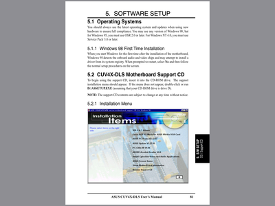

At the ASUS CUV4X-DLS I use 2 x Pentium III-S 1.4GHz Tualatin with 2 x Lin-Lin adapters.I didn't modded the Bios and I can overclock them until 1.74GHz (10.5x166FSB ) at 1.675v with the voltage selection (with jumpers of the Lin-Lin adapters). The max FSB of the motherboard is 166MHz.
Reply 11 of 31, by looking4awayout
Interesting... Does the BIOS let you change the FSB? Mine doesn't, forcing me to use CPUFSB in Windows.
Reply 12 of 31, by Obijuan1983
Yes you can adjust FSB via Bios settings.
765.29 KiB
1218 views
Reply 13 of 31, by looking4awayout
That is very cool, thanks! I will consider it as a future upgrade for my RDD.

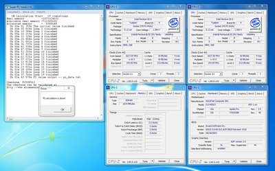

2 x Pentium III-S 1.4GHz @ 1.725GHz
249.57 KiB
1109 views
SPi 32M
2 x Pentium III-S @ 1.68GHz
291.42 KiB
1108 views

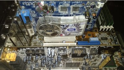

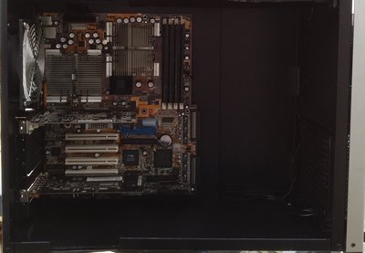

Reply 18 of 31, by Obijuan1983

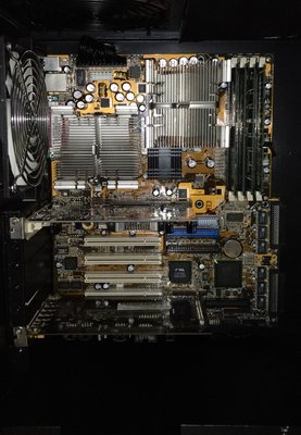

Today I started to build the rig in the modded case I had.
Its a Lian-Li PC60, painted black inside and added a side window.
I also did a cable modding to hide the 24pin ATX cable and power button.
Waiting for the PCI to SATA adapter to add the SSD and 2 GB RAM (4x512MB PC 133)
Next step is to watercool the dual PIII-S...
