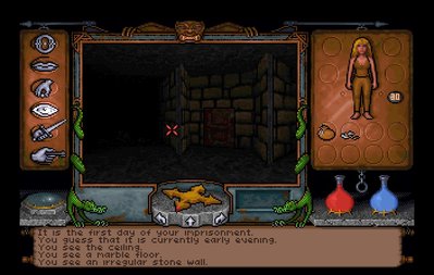

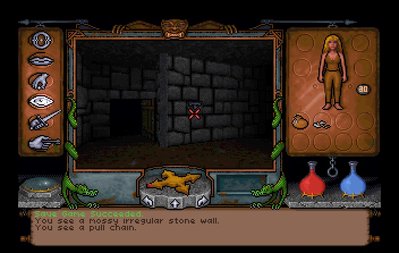

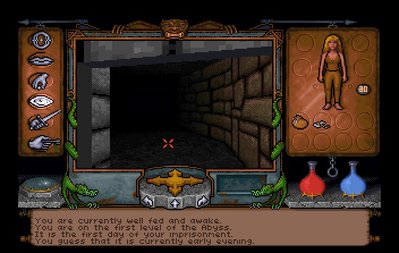

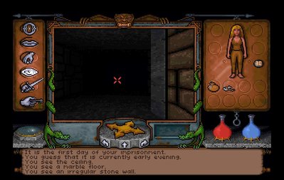

Does Ultima Underworld even use plain protected mode(other than what EMM386 uses)? Or is it just a MS-DOS mode program with EMS that happens to be implemented using protected mode?
Edit: I do see paging is enabled and something(which doesn't seem like EMM386, since it only uses segment selector 0x28 afaik) is running in protected mode. So is that Ultima Underworld itself?
Edit: It seems to run without problems, at least up until the main menu(where I found out I didn't load any mouse drivers). Then couldn't figure out how to quit the game(Ctrl+Q, Q etc. did nothing).
It seems to run quite well, with a mouse at least:
The attachment 1026-Ultima_Underworld-2_savegameworks.jpg is no longer available
The attachment 1026-Ultima_Underworld-3_curvywall.jpg is no longer available
The attachment 1035-Ultima_Underworld-4_bigroom.jpg is no longer available
The attachment 1036-Ultima_Underworld_5-3D_doorentry.jpg is no longer available
So as you can see, it seems to run fine!
Edit: Speed is still an issue, though(only ~20% realtime speed atm).
Edit: So that means there's no problem with basic protected-mode operation?
UniPCemu Git repository

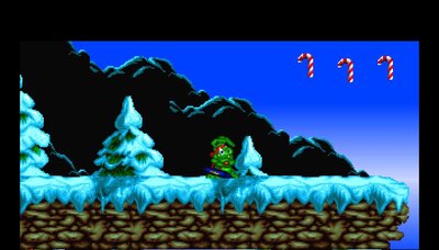

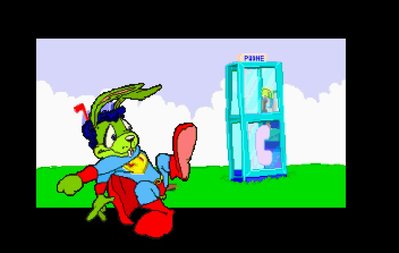

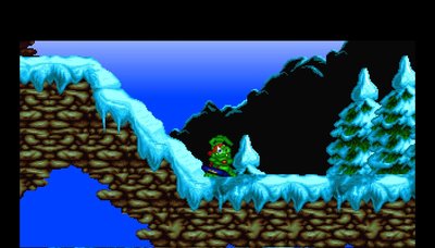

Just tried running Jazz Jackrabbit with only himem. It finally runs! 😁
The attachment 1037-JazzIntro.jpg is no longer available
The attachment 1045-JazzChristmasLevel.jpg is no longer available
The attachment 1040-Who doesnt like candy.jpg is no longer available
Although entering a safe filename when saving from there seems to have unresponsive input? Sound and visuals are still running, though.

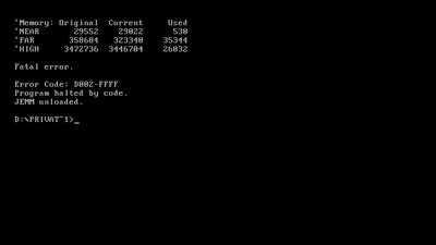

Just tried Privateer. It gives me an error code "D002-FFFF"?
The attachment 1046-Privateer1crash.jpg is no longer available
Edit: I did ran install, configuring both audio settings for SB, IRQ5, DMA1(as is used in UniPCemu).
I do see a #TS fault starting it, on an IRET from task 0xF0 to task 0x10?
Edit: Said fault is because, after loading CS(not loaded SS yet), TR's DPL isn't equal to CPL?
Edit: Said bug was a requirement for CPL==TSS.DPL, instead of CS.RPL==CS.DPL. And then it was even applying it to V86 mode(which it shouldn't, as it doesn't have CS.RPL).
Edit: Filtering out faults from V86 mode, I see no faults. But said crash still occurs. So there's a problem in V86 mode somehow?
Edit: The same with non-#GP faults from V86 mode. Hmmm...
Edit: All I see is #GP faults pointing to interrupt vectors(I bit in the error code being set)?
Edit: And #GP(0) errors.
