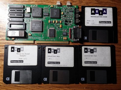

I've seen a few posts about this card around here over the years but very little information, recordings or other notes about them. It might be helpful if we compile any known links, files or other information about these cards here. I'll start off with pictures of my card. I got this one in a scrap lot, which is why it is missing the rear bracket. Surprisingly I also found driver disks being sold online around the same time, so I grabbed those too.

So far, the installation media appears to "work" but I have yet to get the card working. The system I have it installed in is probably just too new or fast for the card (it is a Pentium 2 450Mhz). The problem I have is that the DOS driver installs but whenever it attempts to test the card it says it is not physically installed in the system, even though all of the other parts of the installation appear to work. The Windows driver also attempts to load but it says it cannot find any of the card's components at any of the interrupts specified.
I can totally rule out system speed by testing this in the 386sx I just finished putting together. I will report back here once I've tested this.
In the mean time, if anyone has any useful ARIA related links, threads, files, repositories, FTPs, articles or anecdotes, please post them here! A list of games\applications that natively support the ARIA's proprietary MIDI functionality would be most helpful too.
The Sierra Semiconductor ARIA16 is a pretty odd soundcard chipset that evidently requires a lot of direct software support and isn't universally compatible with MPU-401 MIDI or FM (OPL2\3) music. I guess even SoundBlaster digital playback requires some extra software. In this way it reminds me of the Gravis Ultrasound. Once I can get mine working I hope to learn more about it and whether it is worth using in a retro PC or if it is better left as a neat collectors item in a box somewhere. 😀
Interesting things I've noted about this particular card:
*It has sockets for more memory, where as some versions just have empty solder points.
*There are absolutely NO jumpers or DIP switches on this, which is very different from the rarer Diamond Sonic Pro Aria16 card.

Small update. I made a bit of progress with this card but not much. For some reason the disks I had do not have any of the .bnk files required by the "playmidi" application to play back midi files. Using an already-extracted installation of aria drivers I found online, I was able to get the card sort-of-working on my 386sx system. It will play midi files with the aria\utils\playmidi.exe application. They sound absolutely horrible though. On most tracks the music is extremely quiet and the percussion is really loud.
Sadly, my 386 isn't fast enough to play any aria-supported games, so I tried it again on my 450Mhz PIII tester system, and sure enough, it all seems to work but I get no music with playmidi. I have basically confirmed that the card is speed sensitive though, because I disabled L1 and L2 cache on this system and playmidi does work (still sounds horrid though). I tried playing Arena with the aria chosen for music and effects but I get no sound with the system at full speed or with caches disabled, so I don't know what the problem is there, but with playmidi at least it requires something far slower than a P3.
It's starting to look like I really should finally put together a 486 system (with Windows 3.11 too) to test these picky early-90s cards.
Also, I've attached the driver zip I found online. I got it from one of the popular driver download sites. The file dates seem to be several months newer than the ones on my installation disks.

Got my hands on a Prometheus Aria too. Was wondering if you'd gotten it completely working on that 486...
I'm trying it out in a Cx5x86-120 system and SB is working fine, AdLib is working as designed (hilariously awful), but despite everything in diag checking out for GM on P330 I9, I can't get any MIDI output at all. Doesn't make sense as it runs AdLib through the MIDI engine, so it must be working internally.
I'm using the drivers in the Aria16 directory in this collection btw:
http://vogonsdrivers.com/getfile.php?fileid=7 … &menustate=36,0
(which will only install from root of A:, not a subdir...)

I finally had a chance to test my card. I started off with a 386SX-33 build and used bristlehog's install disk from vogonsdrivers (that I think came from the thread OP's set of disks). The install process seemed to work and arrived at the diagnostics part. Then it crashed. The process had created the ARIA directory and subdirectories. However, there were lots of weird ASCII characters for filenames in the subdirectories.
I tried again with my trusty 486SX-66 system, and the install process got to the diagnostics screen, which did not detect an Aria card. I noticed that the connector had a lot of corrosion across a number of pins and hit it with some Deoxit. That did the trick.
I tried the shareware version of Terminal Velocity, and it sounded really good. I tested the MIDI with the PLAYMIDI app and Grabbag, and it sounded fine. Nothing to write home about, but at least it works.
I'd like to find a game that natively supports the GM but don't know if one exists.
