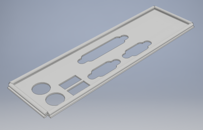

Been modeling some ATX I/O shields for 3D printing the last couple of days, and posted about it in the "What retro activity did you get up to today?" thread. Was kind of surprised by the interest for the models amongst other members, assumed that everyone here owning a 3D printer already would have done something similar, but apparently not. Figured it might be an idea to post the models in a separate thread, might be useful to more of you guys 😀
Test printed the shields in ABS. PET should be good too. Haven't tried PLA, but suspecting it might be too brittle, the latching edges might break when installing/removing the shield.
There's been some valid concern about electromagnetic interference in the thread. The simplest way I can think of to combat that is to apply aluminum foil tape to the rear side of the shield, and fold the tape around the edges to make electrical contact with the case, if the contact made by connector shieldings etc isn't enough. Aluminum foil tape is really easy to work with, and readily available at any well stocked hardware store. Copper foil tape would probably be even better, since it's designed for this kind of purposes, but it's quite expensive, and probably not trivial to get hold of everywhere. There's also copper foil tape used to keep slugs out of flower pots etc that might work, which probably is cheaper and more readily available.
If you got any suggestions on how to improve the shields, please tell me 😀
Reply 1 of 73, by kaputnik

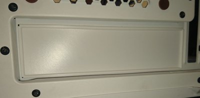

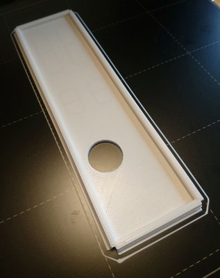

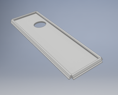

The first model is a blank shield.
Printed it in ABS with good results. Had however to compensate for thermal expansion, did that by simply scaling the model in the slicer app, 100.3% worked well with my printer. Strange that the slicer software won't do this kind of compensation automatically by the way. Or maybe I just didn't let it cool down sufficiently before removing it from the heat bed.
Print the shield with the front side up, and let it slowly cool down to room temperature on the print bed before removing it, to minimize warping and thermal contraction. Used 0.15 mm layer thickness. Set infilling to solid.
Attached .stl file ready for slicing/printing, and the original Autodesk Inventor 2018 model for own modifications.

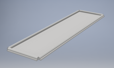

Edit: also added a blank version of the thicker and generally sturdier AT shield in the next post. It's 2 mm instead of 1. The modified latching edges works better in my opinion too, even if they're not as elegant. It might be better suited for machining cutouts. Would however still recommend the 1mm one if doing it by hand with a knife etc 😀

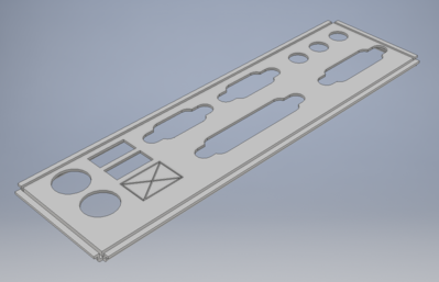

Reply 2 of 73, by kaputnik

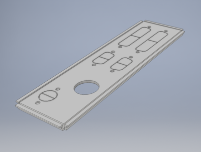

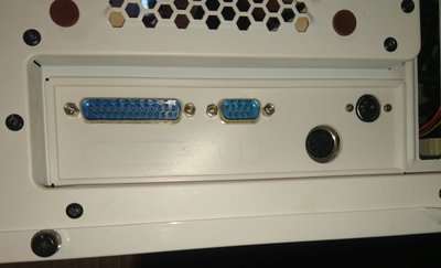

The second shield is customized for AT boards in ATX cases. Besides the premade cutout for the AT keyboard connector, there are cutout guides for two DB25 and two DB9 ports. There's also a guide for a PS/2 connector of the kind that's mounted in an expansion slot bracket. The connectors seems to have a somewhat standardized form factor. Nice to not have to waste an expansion card slot on that. Had to keep the guides quite narrow to avoid roughness on the front surface, but it's still not too hard to do the cutouts with an X-acto knife or similar.
Otherwise compared to the blank shield, I adjusted/improved the latching mechanism and upped the thickness from 1 to 2 mm to make the construction sturdier, since D-subs and PS/2 connector will be mounted directly on it.
The location of the PS/2 cutout might not be the most aesthetically pleasing. Wanted to keep it as far away from the mobo and anything it could collide with as possible. Tried putting it right above the AT connector first, but after finding an actual PS/2 connector in my stashes, I realized it would never fit there. Didn't want to remove a DB port cutout to make room for it either. Might however make an alternative version with only one DB25 cutout after doing some other stuff I got in mind, if there's interest 😀
The same printing suggestions applies here too, print the shield with the front side up, and let it slowly cool down to room temperature on the print bed before removing it, to minimize warping and thermal contraction. Used 0.15 mm layer thickness. Set infilling to solid. This model did however not need any scaling, dunno why.
Not gonna use this one myself, so I'm especially interested in feedback from actual users here 😀
Edit: did a small cosmetic fix, moved the PS2 cutout into line with the upper row of D-sub ones. Updated the Inventor file and added an updated .stl. Left the old .stl since I haven't test printed the new one.
Edit2: Also uploaded a version with a bit higher and thus more flexible edges, that should work better with PLA, or if you generally have problems with edges breaking when installing. See this post.
Edit3: kuenzign added optional gameport and onboard PS/2 port cutout guides to the original design, clicky.

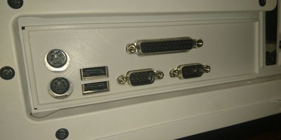

Reply 3 of 73, by kaputnik

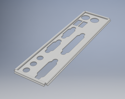

Noticed that many 440BX boards and their counterparts with other chipsets from the same era seems to share a common connector layout. Would guess it was standardized in the beginning, but haven't really looked into it. Did a shield model with cutouts for this layout, found on two different 440BX and a 440LX board of mine. If I'm right, there should be a lot of boards out there using it.
Oddly enough, there seems to be a slight height difference between the PS/2 connectors on my different boards. Check photo, it's the board that deviates the most. Could move the holes if the pictured height is the more common.
Did variants with both the 1mm and 2mm base shields. Up to you to decide which one you like best 😀
Attached .stl files ready for slicing/printing, and the original Autodesk Inventor 2018 model.

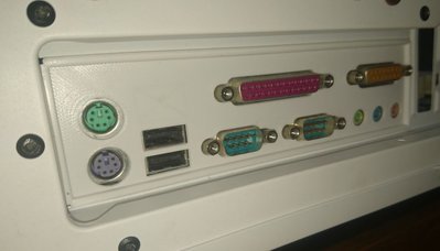

Reply 4 of 73, by kaputnik
When the manufacturers started to include onboard sound, it seems like many of them kept the old common layout, and just added 3.5mm jacks and a game port to it. Even seen a board with a network connector added to the same layout, above the USB ports.
All cutouts except for the network one are premade on this model. Added cutout guides for a network connector if you got one, should be easy enough to open up cleanly, since all needed cuts are straight. Just do the cut closest to the USB ports first.
1mm and 2mm variants available here too.
