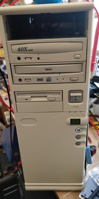

If you've seen my post about computer I just bought (Bought these (retro) hardware today), you know what I'm talking about.
So I just received this computer with a beautiful case
1018.13 KiB
589 views
but as you can see, the power button is missing ...
I don't think they took the time to manufacture these switches themselves, so I'm wondering if I can't just buy a new one and snap it in there ? Question is, where can I buy the proper rocker switch ?
Has anybody replaced this kind of switch before ?

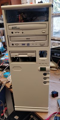

Reply 3 of 17, by Deksor
Well the previous owner have tried that, and he failed as you can see ^^
1.2 MiB
560 views
I'm gonna measure that hole to see what could fit in there
@Nprod that switch looks close to the look I'm looking for, thanks !
Edit : hole is 2.5cm*2.5cm

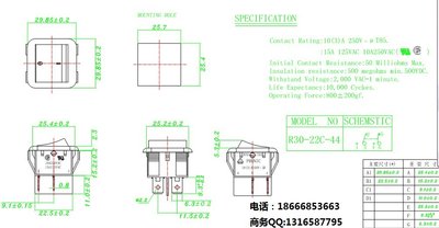

Reply 8 of 17, by Nprod
Here are all the dimensions:
117.42 KiB
484 views
Standard mounting hole is listed as 25.4x25.7, this might've been the very same model of switch that was in there from the factory.

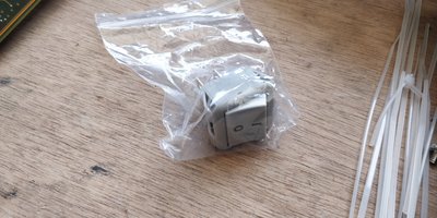

Reply 17 of 17, by Deksor

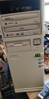

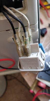

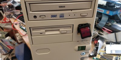

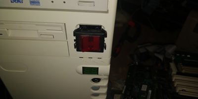

Well I received the switch today :
1.83 MiB
331 views
the old switch
1.11 MiB
331 views
placing the new switch in place
747 KiB
331 views
and it fits PERFECTLY 😁
1012.91 KiB
331 views
The case is finally complete 😀
971.53 KiB
331 views
Thank you all for the help !
So indeed the switch was the correct one, and it doesn't feel like cheap crap either, it feels like any other switch really.
