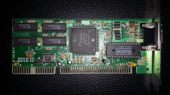

Hiya all,
Is it possible to upgrade the VRAM of my Trident 9000i from 512KB to 1MB? 😕

Reply 5 of 11, by Grzyb
foxbat wrote on 2025-09-15, 22:27:
Are you sure? I have TVGA9000i 512kB and couldn't get more than 800x600 16 colours. The manual says same: https://www.minuszerodegrees.net/manual ... Rev. B.pdf ???
Let me guess: that card has 100 ns RAM chips, right?
For 800 x 600 x 256 you need 80 ns RAM.

Reply 6 of 11, by darry
Grzyb wrote on 2025-09-15, 23:04:
The card in OP's first post has 80ns DRAM, if I am not mistaken.
The manual linked here is indeed likely from a card with 100ns DRAM.
And your guess is probably quite accurate

Reply 7 of 11, by st31276a
My 9000i has two types of ram chips on it. Two are normal dip and the other two are funny upright ones, they look like oversized resistor strips with square corners.
One kind is 80ns and the other 100ns. I cannot remember which is which, but I think the funny upright ones are 100ns.
I have this one since new, I "upgraded" to it back in the day to get 256 colours in windows 95. Was the cheapest and didn't know any better back then.
This specific specimen can run 800x600 in 256 colours, but it looks like crap and the screen shimmers. 640x480x256 is fine though. Thought it was the monitor back then (only used to run 640x480 up until I got the card) but now I know the card also had a healthy contribution to the situation.
Watching it paint the screen is quite painful.
Rather go for a 8900D, it is double the speed.

Reply 10 of 11, by dionb
That datasheet makes no mention of VRAM and is quite explicit about DRAM. I doubt VRAM would even work, regardless of quantity or speed, and generally VRAM actually has lower DOS performance compared to DRAM on the same chipset. OCing the ISA bus might make more sense and upgrading the 100ns DRAM to 80ns; that would enable non-interlaced modes at other resolutions. But the card would remain a complete slug whatever you do to it.
Reply 11 of 11, by darry
dionb wrote on 2025-09-16, 12:57:
I think VRAM in this context was meant to mean
"Ordinary DRAM used as video RAM, hence VRAM"
