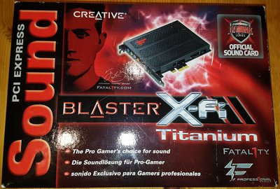

Reply 6 of 12, by Baoran
I still have my old sound blaster X-FI stored. I didn't put it in my main PC when I built it in 2013, but I always wondered how it would compare to the on board audio of Asus Formula VI that the system has. I also don't know if it has standard front panel connector because the small manual that came with it doesn't say anything about that and just concentrates on the optional I/O drive upgrade.
Seems as though the Titaniums are one of the cards that force you to use the I/O drive from my research. Similar story to most of the X-Fi cards except for the lower end ones it appears.
Now, I found the Audigy Rx series of cards. They're PCI-E but they've got a audio header on them too. Are these any good compared to the X-Fi cards? They still seem to be made nowadays which is nice
