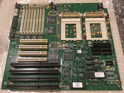

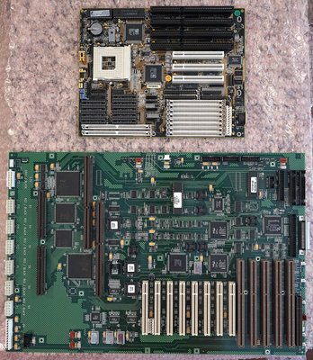

Here is a spare ALR motherboard that I have for the HS/6 and a 486 motherboard next to it for scale. I have to be careful how I store this motherboard as it bends very easily because of its length and weight.
1.73 MiB
4037 views

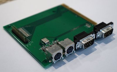

The I/O card that goes into that slot. You can see the parallel port connection on the left.
713.29 KiB
4037 views

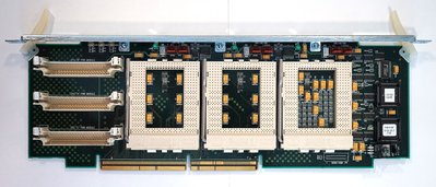

Triple Socket 8 CPU board.
803.63 KiB

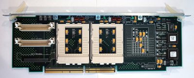

Dual Socket 8 board if you want to build out a quad CPU system. Notice it's just a triple CPU board with the third CPU socket and VRM socket removed.
797.7 KiB
4034 views

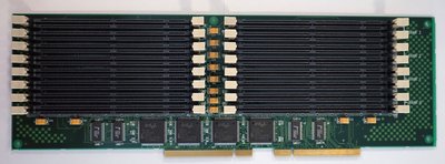

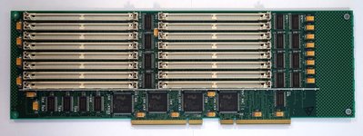

Unisys HS/6 ALR SIMM memory board.
920.91 KiB
4034 views
Unisys HS/6 ALR DIMM memory board.

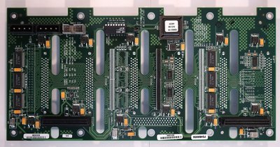

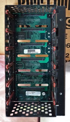

SCSI backplane 80-pin SCA drive mount side.
973.99 KiB
4028 views

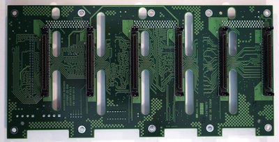

SCSI backplane 68-pin controller cable attachment side.
1.17 MiB
4028 views

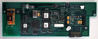

LCD touchscreen controller board. (rack version)
750.99 KiB
4028 views

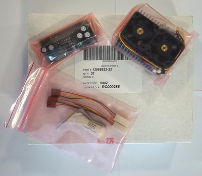

I saw five boxes that had a Unisys logo on them, but no Unisys part number.
731.88 KiB
3899 views

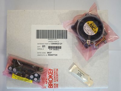

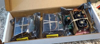

On opening the box I found three sealed Pentium Pro 200MHz 1MB cache CPUs with the HSF already attached and an accompanying VRM board. Apparently these were packaged for one triple Socket 8 CPU board. I left the other four boxes sealed since I knew what the rest were.
777.59 KiB
3899 views

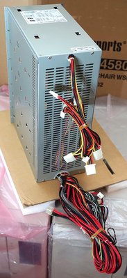

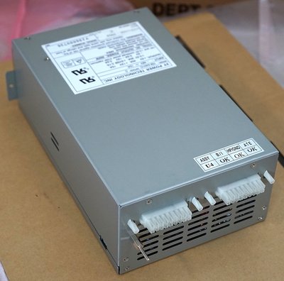

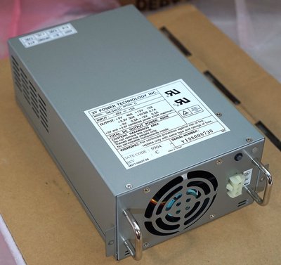

Aquanta power supply (DC variant).
993.02 KiB
3899 views

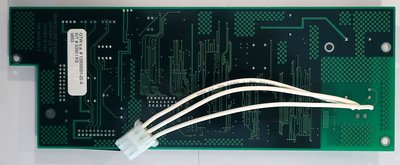

Backside of the PSU.
1019.98 KiB

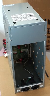

Here is the PSU cage unpopulated. Notice the top slot has a metal plate cover. These Unisys Aquanta HS/6 systems came preconfigured with three PSUs already populating their PSU cages and left room to add one more.
702.34 KiB
3899 views

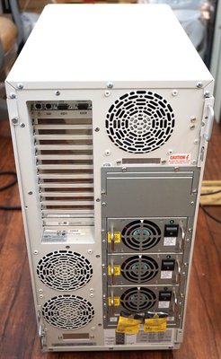

Here's the back of a Unisys Aquanta HS/6 with its PSU cage installed and three PSUs populating the cage.
922.09 KiB
3896 views

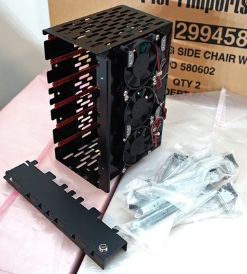

Here is the RAID cage that will be installed.
1.1 MiB
3896 views
A side view of the RAID cage. Notice the three large cooling fans. When running six 10,000RPM or even 15,000RPM SCSI drives you want all that heat dispersed quickly. Those are the drive rails to the right of the cage and to the left is the RAID cage drive security bar that can be locked into place vertically so drives can't be removed.
1.19 MiB

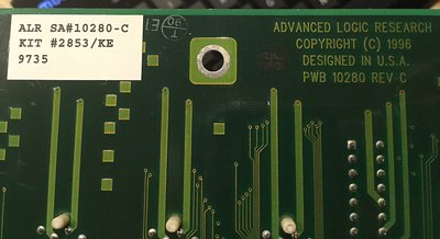

I also acquired in the haul almost two dozen new old stock ALR dual Socket 8 motherboards, in two variants, that I am finding homes for as well. So far I have given them away to collectors and preservationists around the globe at no cost, other than shipping, who are already ALR 6x6 owners or who will be shortly. All the on-board barrel batteries had to be clipped because they were all starting to leak, but luckily no damage came to the larger motherboard models and some of the smaller model motherboards had some trace oxidation, but nothing catastrophic. Both models can accept an external battery as a replacement.
I have about nine of these models left:
1.82 MiB
3676 views
913.09 KiB
3676 views
...and eight of these models left:
1.79 MiB
3676 views
980.9 KiB
3676 views
The big news is I will be giving away one of each board in my hardware giveaway thread here at Vogons and as for the rest of these ALR motherboards I will be selling most of them on Ebay in which I will be donating 50% of the proceeds after Ebay and PayPal fees between Vogons and DOSBox equally since they both have helped me greatly in enjoying this hobby.
