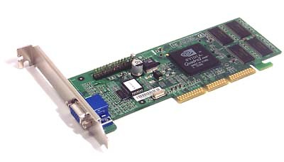

So now I'm onto the video card. I initially tried an nVidia GeForce FX5500 but the benchmarks with DOS games were sub-par, and I'm getting slowdown in games where I wouldn't expect slowdown on a 300mhz P2 processor. such as Commander Keen 4 and Duke Nuke'em 3d on any VESA resolution. I've done a ton of reading up on this topic in this forum and elsewhere, and I've concluded that anything newer than a GeForce3 card is not optimal for DOS gaming. Is this an accurate conclusion? I also have experienced first-hand a lot of horizontal scrolling issues with ATI cards, so I'm staying away from those.
So onto my budget - I'm trying to keep the price of the card at $30 or less, and again, it has to be new-old-stock. A GeForce3 card is out of the question as it is far too expensive. Voodoo cards are obviously way out of the question as well.
So here are the cards that based on my research seem suitable for my build and are in the $20-$30 price range new:
-nVidia RIVA TNT2 Pro - 32MB
-nVidia Quadro2 EX - 32MB
-nVidia Quadro2 Pro - 32MB
-nVidia GeForce2 MX200 - 32MB
Which of those cards are best-suited for high-DOS compatibility and early Windows games and will run well in an AGP 2x slot on a dual-P2 board? Info on the Quadro2 cards is sparse, but as best I can gather they are based on the GeForce2 MX400 chip which has a 128mhz bus compared to 64 on the MX200 card. I also can't find any difference between the -EX and -Pro variant of these cards. Also, is 32MB ram sufficient, or should I be spending a little extra to get a GeForce2 MX400 card w/64MB ram?

Reply 8 of 15, by havli
Quadro cards should run games more or less the same as GeForce with the same GPU. In this case Quadro2 Pro is equivalent of GeForce2 Pro and Quadro EX is very similar to GeForce2 MX / MX400.
When using Pentium 2, performance of all these cards wil be limited by CPU in most (if not all) games... unless you aim for high resolutions like 1280x1024 or more. 32 or 64 MB makes no difference here and I think even the 64-bit MX200 should be fast enough. However MX200 might not offer very good image quality - it was designed to be very cheap and therefore the VGA output can be blurry. It depends on luck. Quadros should be better in this regard. And they (sometimes?) have DVI which can be useful when using LCD. On the other hand DVI on this GPU generation might be problematic sometimes... I can't really say how it works in DOS.

I wouldn't be so sure, Quadro cards can have strange VESA shenanigans - you never know.
Reply 11 of 15, by bmwsvsu
Once thing I notice looking at the Quadro MMR and EX cards is that none of them have heatsinks on them.
Would that be an issue? Or do these somehow use less electricity than their GeForce counter-parts?
Reply 12 of 15, by oeuvre
If it doesn't come with a heatsink... it won't need one.
Reply 13 of 15, by Weebob
A lot of Geforce 2 MX's didnt have a heatsink. I have a Jetway branded one with the GPU clocked at 166mhz that doesnt
My Quadro MXR (200mhz gpu) has a heatsink.
Reply 14 of 15, by bmwsvsu
I ended up going with a Quadro2 MXR card. Initial testing looks promising - the slowdown I was experiencing on Duke Nuke'em 3d and Commander Keen 4 on the GeForce FX5200 is gone completely. Now I can play Duke 3d in full 800x600 resolution mode without any slowdown and Keen plays great as well.

Seeing as it's a dual CPU config, I totally support the choice of a Quadro 2. Back in those days, only professional workstations would have dual CPUs, and since the Quadro series are workstation cards, it just seems appropriate.
The Quadro 2 MXR is based on an updated NV10 (GeForce 256), called NV11. Faster clock speeds, but only 2 pixel shaders.
