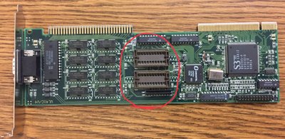

VLB graphics DRAM ?
First post, by Intel486dx33
What is this memory called and where can I find it ?
Reply 1 of 1, by darry
SOJ 40-pin 512K RAM chips, most likely . It should be of the same type and speed rating as the RAM already installed (that is either DRAM, EDO DRAM or VRAM, sorry I can't make out the part numbers from your photo).
