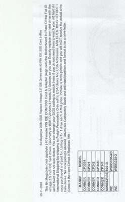

To replace the Conner CP-3024 on my old Compaq SLT, I bought an SSD on eBay. (A "new" Conner is to expensive..)
It was a part from WD, indicated as :
64 Megabyte DOM SSD Replace Vintage 3.5" IDE Drives with 40 PIN IDE SSD Card
On the description was mentioned "to replace Conner CP-3024 etc."
Did anyone had succes with it? I tried but ... nothing

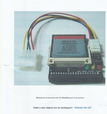

Reply 1 of 13, by kixs
This is the common CompactFlash-to-IDE adapter with CF card. I use it all the time. This adapter has female connector so it goes directly to IDE connector - you don't need the cable.
Otherwise you need to set the correct C/H/S info in the BIOS. Boot it with some DOS boot floppy and prepare it like any other hard drive. FDISK to make partition and then format it as system drive. Install DOS and you're set.

That Compaq is a very old machine; one of the early portables . The bios only recognizes 4 types of harddisks (10,7 - 21,4 - 71,3 - 30,3 MB).
When you insert the SSD before you power up, nothing goes on (no light, no startup-sound by the diskettedrive) although you see the powerlight on the SSD-card.
When you insert the SSD while the machine is running, all goes black.

Hereby a picture of the CF2IDE. I also upload the description of Western Digital CF
And then I'll lwatch the old tread. 😀

Reply 10 of 13, by rasz_pl
dead computer after plugging cf2ide usually means it was plugged backwards, now I would advise _against_ checking this hypothesis by experimentation
rather look at the pcb and identify where pin 1 is, or even better check pinouts with multimeter (ground pins easy to find)
Reply 11 of 13, by wulp
Proved: de cf to ide was broken. Bought a new one and it works great!
