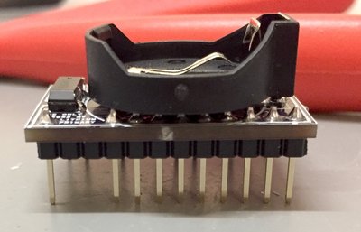

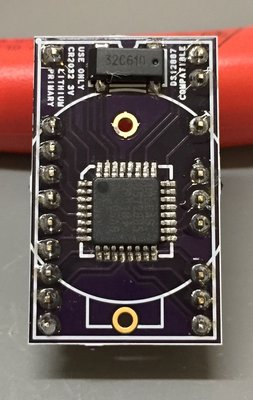

It turns out Maxim has current-model parts, like the DS12885 -- a QFP-32 surface mount part that uses an external 32kHz crystal and lithium battery. These are backward-compatible (or, I've heard, usually compatible) with the original DS1285/DS1287 parts. So, I created an adapter board:

... and an external CR2032 coin cell holder:
22.94 KiB
860 views
11.54 KiB
860 views

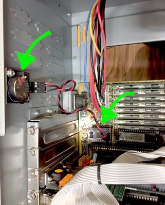

I used header connector parts from FrozenCPU and some 24AWG stranded wire from a local electronics supply shop and created a cable. Here's the end result:
273.76 KiB
860 views
It took a couple tries. The first problem was a simple footprint issue. Apparently, it's not possible to get perfect PCB layouts on the first try, ever. The holes for all the header pins needs to be a step larger, so I had to clip the ends of the pins off and basically just tack them to the bottom of the board through the hole. Not ideal, but it's solid enough.
The second issue was a tiny, hardly visible solder bridge between the Reset and Data Strobe pins that kept the board from POSTing. I thought I was out of luck, but eventually noticed the bridge and, once fixed, it fired right up and FINALLY saved my settings! The floppy drives are now properly detected, SCSI card settings fixed, and Day of the Tentacle installed from CD! 😁

Finally revisited the RTC replacement PCB. I decided to take a queue from some of the comments here and integrate the coin cell holder. I still have a copy of this project with the pins for external batteries, but in reality, it's just a lot more convenient to use CR2032s everywhere.
So here's the new PCB. First step is to solder in the RTC chip, 32kHz crystal, and the pins.
219.49 KiB
485 views
Then, add the coin cell holder on top.
185.8 KiB
485 views
And presto, RTC sammich.
184.42 KiB
485 views

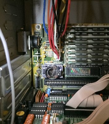

I replaced the previous version in my 386DX/40, since the pins were only tacked onto the bottom surface of the PCB. This one has large enough holes so the pins can actually go through the PCB. 😉

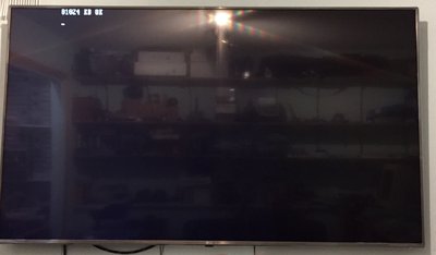

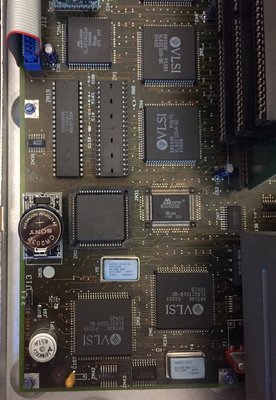

And now, let's try to get that PS/2 Model 30 - 286 running. I probably should've used different (round?) pins, because this socket is TIGHT. Maybe I just need to replace the socket. For now, it's not fully seated, but it's not going anywhere.
252.35 KiB
481 views
SUCCESS!! After locating the proper startup disk image online, it finally boots without errors 161 and 163!

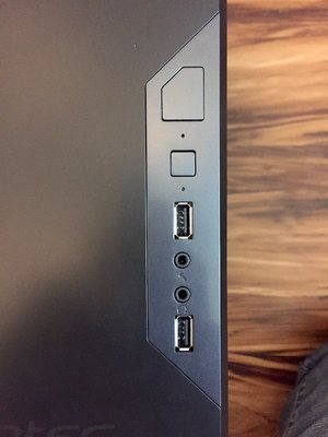

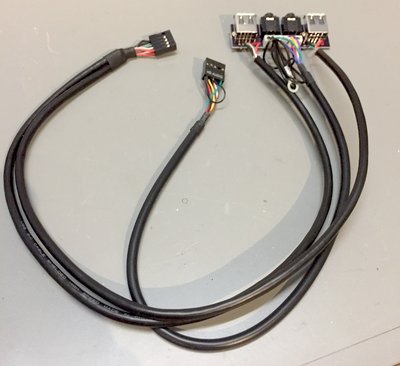

Since I was ordering from OSH Park anyway, I put together a replacement front panel PCB for my Antec VSK case.
I really like this case. It was about $35 locally, without a PSU. It's definitely not built like a tank, but it seems the corners cut were reasonable compromises. Everything fits nicely and it looks pretty smart.

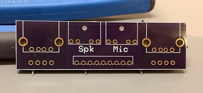

However, new cases all ship with USB 3.0 now, which obviously uses a different header connector than the USB 1.x/2.0 headers on retro motherboards. I have an Asus TUSL2-M installed in this case, with a Pentium III Tualatin 1.0GHz processor -- definitely not USB 3.0. I don't really like cluttering up the insides with adapters, so I ordered some USB jacks and designed a replacement board.
110.44 KiB
467 views
I bought some USB header extensions from Ebay and chopped off the male end, then soldered it directly to the PCB.
110.68 KiB
467 views
Fits like a glove!
168.63 KiB
467 views
Another completed build. 😀 Well, it's still waiting on a Plextor DVD/CD drive to show up... So almost complete.
    219.53 KiB
    467 views

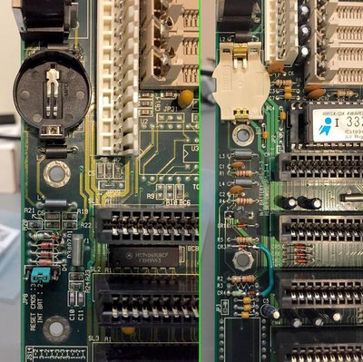

Another update in the saga of vintage time-keeping. This time, I'm working on two 486 motherboards that had rechargeable barrel batteries. I wanted to convert these to use CR2032 coin cells as well. This isn't a drop-in replacement -- the coin cells aren't rechargeable and thus need some minor circuit hacks to avoid damaging anything.
First victim uh, subject is a Chaintech 4ULD.1:

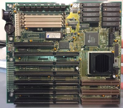

602.02 KiB
328 views

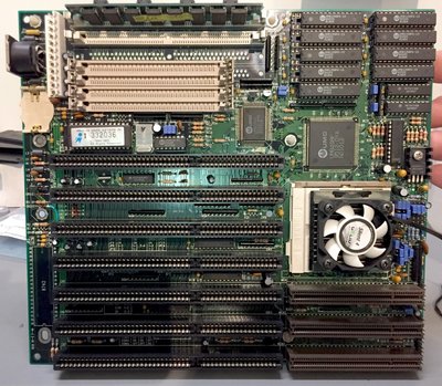

The second is an Aquarius MB-4DUVC mk 1. This is the board I'm using in my current 486 DX/2 - 66MHz build:
655.89 KiB
328 views

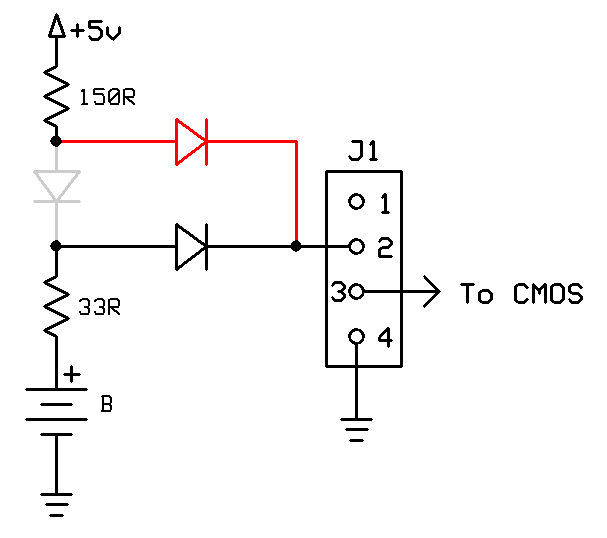

Both of these had a similar circuit, where the battery would run through a small-value resistor, a protection diode, and then appear on one of the pins on a CMOS configuration jumper. Placing the jumper on pins 2-3 would connect the internal battery to the CMOS, while placing the jumper on pins 3-4 would clear the CMOS settings.
The problem is that the original circuit would also connect the battery to the +5V rail via (something like) a 150-ohm resistor and another protection diode. This needed to go. However, simply disconnecting this part of the circuit would mean the CMOS and RTC were always running on battery, potentially draining the coin cell more quickly. So, I wanted to modify the circuit to allow the system to run from the PSU when powered on, and from the battery otherwise.
The modified circuit looks like this, where gray is a removed component and red is an added component:
5.65 KiB
328 views
Finally, a close-up of the rework:
276.35 KiB
328 views
Luckily both boards had multiple footprints where the barrel battery goes. Each had a 20mm spacing that is compatible with standard coin cell holders. Unfortunately, the Aquarius board did not provide ample room for the holder itself, so I had to find a slightly smaller one. Naturally, I forgot to order the required cap that actually holds the coin cell in place, so I'm hoping everything still fits when I finally get around to putting it together.
But there it is. Both boards are now ready to go for a couple decades free of amnesia. I think that concludes all the outstanding issues I have with RTCs.
