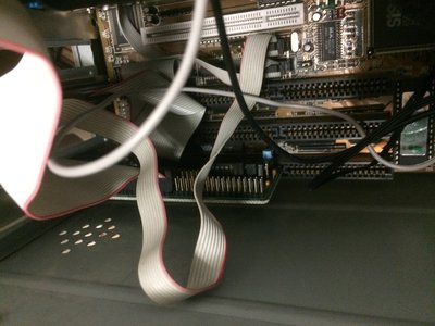

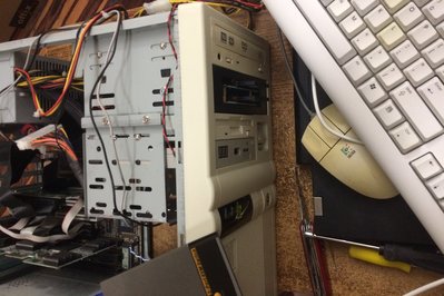

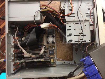

I've been looking at all the late model socket 3 stuff on here with envy for years and finally decided to jump in and bought some hardware on ebay.
I found a combo of an LS-486, 32mb of fastpage ram and an AMD 5X86 133mhz. It took several months to arrive but I have it up and running today in an old AT case I found locally. I'm using an ATX to AT adapter also purchased on ebay with a several year old Coolermaster 460watt power supply. I also picked up 2 more 16mb modules of fastpage ram locally while waiting for the MB/CPU to arrive.
I mounted a couple of IDE to compactflash adapters in a 5.25" plastic drive bay thing I had and I've put 2 8GB cards in there and I have those connected to a Promise Ultra 133 TX2. The DVD drive in the top bay is not connected and only the 3.5" floppy is connected as I can't find a floppy cable with 2 drive connectors and I also haven't quite figured out how to use the floppy drive emulator. Ultimately I'd like both to be connected and working.
I'm stuck running an ancient ISA ATI VGA wonder at the moment, none of the PCI video cards I have work with this motherboard (Geforce 6200, Matrox G450) I was really hoping the Matrox card would as the 2d image quality is tremendous. I've ordered an S3 Virge DX and an ATI Rage XL on ebay, hopefully one of those two will work.

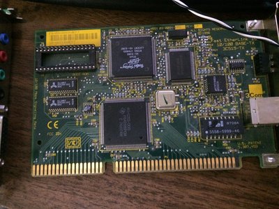

I've got a Sound Blaster 64 and a 100 megabit 3com ISA NIC I plan to install. I doubt I'll have it connected to my network, I just find the idea of a 100 megabit isa network card kind of funny.
I just finished up installing windows 98SE and plan to mostly play some old DOS games from my childhood.

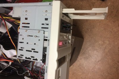

Anyway I've attached a couple of pics of the system, it's a bit of a mess right now and I'll try and tidy it up a bit more once the proper video card arrives.

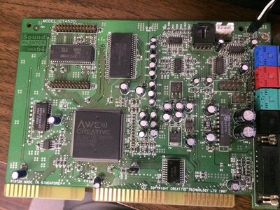

Nice system! These LuckyStar boards are a fine alternative to the late, UMC based, 486 speed kings.
I also have CT4520 and I REALLY like it because of its compactness and great sound... I'm not a sound connoisseur so a card like this is high end for me.
Your more recent PCI cards require a newer PCI "protocol" so the screen stays black. You may read Feipoa's Modern graphics on a 486 which clears things up.

One step forward and another back, S3 Virge is working well, big improvements in various DOS benchmarks from philscomputerlab.com
But the machine randomly freezes in Windows after installing the AWE64. Freezing happens in all 3 ISA slots.
EDIT - this is in Windows 98, same thing is happening with a Vibra16 in all 3 ISA slots.

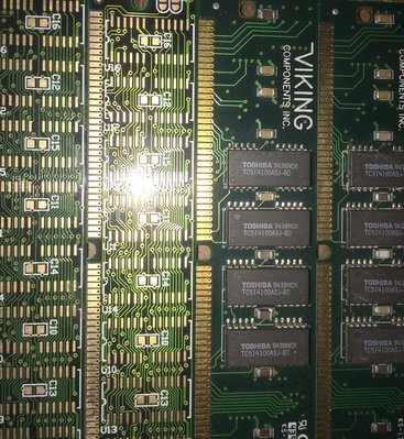

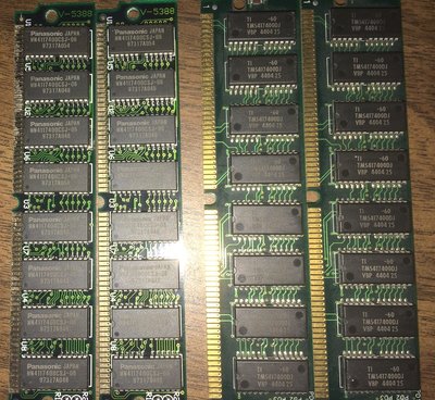

Reply 6 of 17, by pete8475
appiah4 wrote:
On a hunch, check to make sure the RAM you have in the system is FPM not EDO..
Is there a utility I can run to make sure?
When I google part #'s from the chips I seem to get results saying fast page. I'll post pics of the ram sticks in a few minutes.
EDIT - pics attached. I'm going to try just one pair and then the other and see if the crashing follows either set.
EDIT 2 - same crashing with either set of ram and either soundcard. Also locks up when I put in the 3com NIC.

Reply 7 of 17, by amadeus777999
If your board is a C2 revision then you can use EDO(not all later revisions allow EDO though - F does not for example).
Just stick in the ram into an old 486 board which features 72 pin simms - if it starts up the ram is FPM.
Another option is reading the numeric code on the modules - if it ends with 0 then it is most likely a FPM one.
e.g.: HY51V17400BJ-60 -> FPM, HY51V17404BJ-60 -> EDO
According to this method, your Panasonic modules seem to be EDO and the other FPM.
Reply 8 of 17, by pete8475
amadeus777999 wrote:
If your board is a C2 revision then you can use EDO(not all later revisions allow EDO though - F does not for example). Just sti […]
Interesting, I wish I could test them in another board but I don't have anything else that takes 72 pin simms.
I think it is a C2 revision and using the ram with Toshiba chips it still freezes as soon as any sound plays in windows on either sound card I have or as soon as I install the drivers for the 3com ISA network card. Interestingly the old ATI VGA Wonder ISA video card I have works fine.
I have ordered a Yamaha sound card on ebay so I'm hoping that will work with this board so I can have more than pc speaker noises.

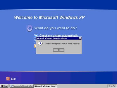

Minor upgrade today, I replaced the Lite-On DVD drive that wasn't actually connected to anything with a 2x CD-ROM and an ISA controller card. Cost was $5. 😎
EDIT - To test the CD-ROM I threw in a Windows XP Home OEM SP2 disk and ran the system compatibility test. Seems this old dog isn't compatible. 🤣

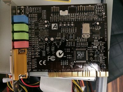

The PCI soundcard finally arrived today! It'll be fun to experiment with tonight after dinner. Supposedly this Yamaha chip has great DOS compatibility.
