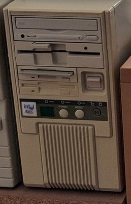

Aha! It's finally done! I have had this build 90% complete for probably a year now, but there have been a few extra things I wanted to do with it that just never got done. But that is no longer the case, so I can finally make a post here about it. 😀
This is my custom Socket 7 build that I wanted to do pretty much immediately after getting my Dell Dimension XPS build running. I originally got that machine because I felt that going the OEM route would be easier and it would for the most part be "just as good." I still think that's certainly the case, but it does nothing to scratch the "I want to build something myself" itch. Scratching that itch was originally part of the reason I built my 486 DX2 build (the other main reason being nostalgia of course). In fact, that 486 build was originally built using the baby AT case I used in this Socket 7 build. When I finally got the case I really wanted to use for my 486, I ended up having a leftover baby AT case to use. Of course, I cannot just let such a case go to waste, especially not when it's in such great shape! What better way to utilize said case then by doing a full custom Socket 7 build?
But what exactly to put in it?

Assembly
Baby AT cases are annoying to work with. Maybe you disagree. I find them cramped, and usually the builds you put in these have many, many little pins to be connected. And apparently all the IDE/floppy cables I have are too long. Ugh. Oh, and these cases could practically be considered weapons with how many cuts you end up with after working with them.
But yes, indeed, many little pins to be connected.
Some AT power supplies come with a little connector that you can hook up directly to the MHz display LED. The one I'm using does not. So what I do is buy these molex-to-3pin connectors that are really intended to be used with case fans (the black and yellow cable in the first picture above). However the specific cables I use for this (I also did the same with my 486) need to be hacked up a bit first. As-is, this particular connector will connect the 12v line from a standard AT/ATX molex power connector which is too much for a MHz display LED. So I just cut the plastic a bit so I can reverse it so the yellow 12v wire connects with the red 5v wire. Finally, the small 3-pin connector on the other end will not fit as is to the pins on any of the MHz display LEDs I have, including this one, so I just shave the plastic a bit and then it works perfectly. 😀 Perhaps there's some perfect cable for this that other people buy which I'm unaware of, heh.
With the motherboard installed in the case, now comes the OMG-super-fricking-annoying task of connecting all the rest of those pins. The Tyan S1590S motherboard is a bit weird with the pins. It's just plain missing ground pins for e.g. the power LED and sleep LED. I assume it's intended for a different type of pin connector that some AT cases from 1997/1998 or so had. At any rate I had to improvise with some cables I bought to borrow the otherwise-unused ground pins from elsewhere (two in total). I also decided that since this motherboard does not have any pins for the turbo button/LED that I would hookup the turbo LED to the sleep LED pin. However, in the future I think it would be a cool idea to rig something up so I could use the turbo button to adjust the FSB and CPU multiplier jumpers to select between two different configurations (obviously to be pre-selected before power on). I need to give this some more thought though, not exactly sure yet how to go about rigging this up.
You may recall above that I mentioned that while having an AGP slot on this motherboard is cool, it ultimately isn't that useful when used in a baby AT case. This picture shows why. You cannot even see the AGP slot because those cables are directly in the way. I'd need to do some really serious, hardcore cable management to clear this space so that an AGP card could be used.
I mentioned that I'd had this build 90% complete or so for about a year now prior to writing this post. In order to write this post and take all the pictures, I had to take it all apart of course. I was willing to do this because it gave me an opportunity to try to fix up the cable management that I had done previously. Believe it or not, but this IS an improvement 🤣 . I owe part of that to the fact that this time I decided to use a master/slave arrangement on just the primary IDE interface with the hard disk and CD-ROM. Yes, this does impact performance in cases where both the hard disk and CD-ROM are being utilized at the same time, but I'm not too concerned. Having one less IDE cable in there really made a big difference! I should maybe see about getting shorter IDE/floppy cables at some point ...

Reply 5 of 11, by chinny22
That case is pretty much what every mid 90's PC's looked like where I grew up. Thats a good thing as I always liked it 😀
Not sure about spitting the "twins" though, Sure V2 SLI may not be needed, but its so sexy!
Reply 6 of 11, by Gered
I never saw this style case back then, but definitely seems like it was very common given how often I've seen them (or very similar style ones anyway) for sale nowadays. But I like it too. 😀
I originally bought the second Voodoo2 in a "I don't care what Phil's benchmarks say, I'm going to do it anyway because it's cool!"-style reaction and had them both running in this PC for a while. But yeah, even though I knew what to expect, I was quite visibly disappointed when I fired up Unreal and saw zero improvement in performance. 🤣
That being said, I guess it would not be totally useless... I could run some stuff at 1024x768 if I wanted to with it.

Reply 7 of 11, by Intel486dx33
Nice, That's my old 486 computer case.
Do you know what model it is ?
Reply 8 of 11, by Gered
No, sorry. Both of these cases have no identifying marks/names about who made them... as is the case for a ton of those old AT cases. That case is for my 486 too (as the case badge seen in the photo indicates) and it took me quite a while to find it.
Toshiba 430CDT
Reply 9 of 11, by tayyare
For me, that case has a lot of nostalgia affixed on it, too. It's the exact case of my first ever PC, an 386SX-16 from 1992. In late 1994, it also became a 486 (Cyrix, 33MHz) with a major upgrade.
