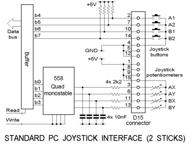

I know the latency is awesome but I'm coming up empty searching bandwidth.
I love this reference: https://en.wikipedia.org/wiki/List_of_interface_bit_rates but alas, no game port listed.
Found this: https://www.descentbb.net/viewtopic.php?t=14252 Logitech's ADI protocol, transmits bits using the buttons at max 10 us per bit, million us in a second, four buttons a port, 8 bits/byte, 1024 bytes/k, 48.828kb/s. At least for Logitech's ADI protocol.
For theoretical max it should come down to max port polling rate of the four button pins.

you cant just multiply 4 bits by ISA bus frequency and assume that to be the max
you need to waste cycles/bits on synchronization

Reply 8 of 11, by awgamer
Effective bandwidth of ISA @ 8bit 4.77mhz being only 1mb after delays: https://www.evaluationengineering.com/home/ar … quisition-needs
By this account, polling a port takes a us: http://www.faqs.org/docs/Linux-mini/IO-Port-Programming.html, would make the gameport's theoretical max on the original pc/xt 488.28kb/s. I'm finding effective rate of PCI being 62-100mb/s depending, so roughly 7.5-12mb/s should be theoretical max for a gameport on a 33mhz PCI sound card.
Reply 9 of 11, by Jo22
Also note that the game port needs some time to "recharge" and that older game ports were speed-sensitive.
Some had variable resistors to correct that little issue.
Reply 10 of 11, by rasz_pl
Thats the analog part (558), afair speed sensitivity was due to stupid 16 bit nop busy loops in game code breaking on faster cpus.
Reply 11 of 11, by awgamer
558 measures the potentiometers, the buttons are directly connected to the ISA bus: http://www.epanorama.net/documents/joystick/pc_joystick.html so the estimated theoretical max holds. Logitech and Microsoft use the analog input to signify the start of a tx, so if mirroring how they operate, a following tx start could be limited to how soon it could follow the preceding one, but the tx itself could be the max button rate. If Logitech/Microsoft's 10us rate were taken as the 558 recharge delay, that'd be 40bits/5bytes, how much could be tx on the button pins in 10us. Even if you were starting a new transfer as fast as it could be done consecutively, every 10us, as long as you were transferring 40+ bits per tx there would be no loss in transfer rate from a recharge.
