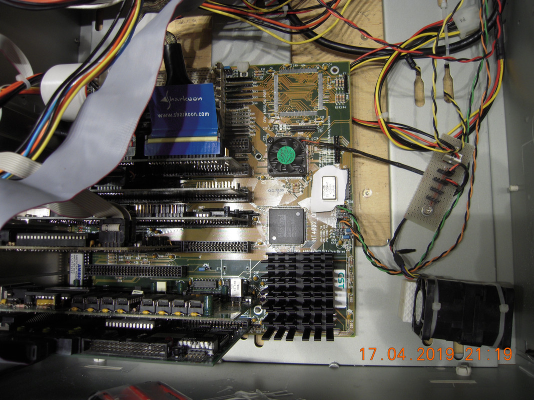

Reply 11 of 17, by retardware
These "PCI fans" trying to move air while being sandwiched are more for the looks than for actual cooling.
Some better cases have fans that blow air through inbetween the cards.
If you don't have such one, there is only the way of improvising.
You can place a blower fan that way that it cools mobo and cards as well.
I have done this in my 486 to keep the rare, hard-to-find hardware alive as long as possible.
These small 4-5cm server fans consisting of two nested fans that each rotate in the opposite direction are highly efficient for that. The ones I use are 4cm diameter, and are rated 0.8 amps at 12V. They offer strong airflow at very small size.
I'll make and post photos later today.
Definitely nothing for "silent computing" fanatics 😀

Reply 17 of 17, by retardware
cyclone3d wrote:
What about cards such as video cards that have fans built on them?
At these low voltages nearby fans' inductive "input" can have noticeable effects.
On graphics cards there is usually a metallic cooler that shields the GPU.
Anyway, I don't think that sandwiched fans are particularly effective.
So my ISA retro PC looks this way:
In the middle you see an Adda fan (shielded by a metallic heatsink) keeping the chipset cool.
In the lower right you see another small but not weak fan (12V 0.8A) that takes care of keeping processor and cards cold.
