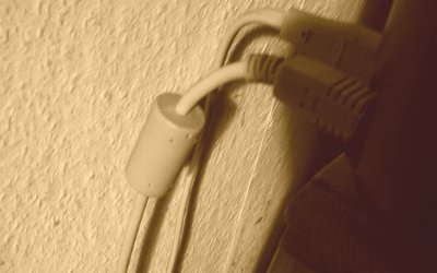

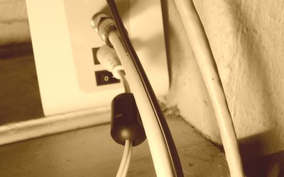

Edit: Added some pictures of the ferrites that I meant.
One is built into a good USB cable (orig. printer cable), the other one was attached manually to a cable modem's PSU cable.
From what I read in a HAM magazine, some people reported that noise went down by 36db after applying such a ferrite to the PSU cable of a DSL router.
Not sure if the numbers are right, but attaching such a little ferrite shouldn't hurt (please prove me if I'm wrong).
