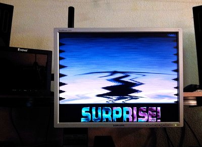

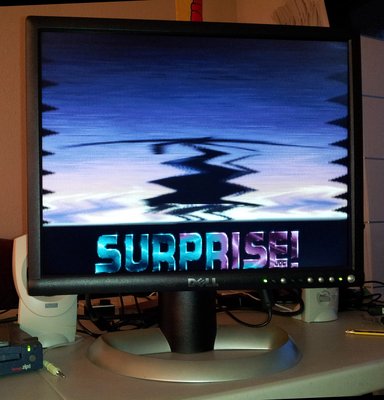

I've found the following to be extremely good at handling difficult VGA tweakmodes and scan rate hacks.
- Dell 2001FP (probably also 2007FP)
- Samsung SyncMaster 214T <-- this is my current general purpose monitor, I have two DOS machines, two Win98 machines, a Mac Mini and my Linux workstation hooked up to it through a KVM. 1600x1200 & great picture quality for its age.
- EUC AGN|PRO EP19AV
238.27 KiB
2411 views
697.24 KiB
2411 views
^^ this scene is basically my benchmark, it messes with the scanline start location & horizontal refresh. A lot of LCD controllers HATE this and just throw a fit. If a monitor handles this demo, chances are it'll be pretty good for just about anything in DOS use.

Oops! Yes, that's the one. Copper by Surprise! a.k.a. "the official pc scene vga card torture test" according to the second Pouet comment. 😜

| Copper | X | | | Wobble sections slightly blocky, as the |
| | | display tries to compensate for the |
| | | changing scan offset leading to a "stair |
| | | step" effect. Have seen this on other |
| | | panels too e.g. Dell 2001FP, but not all. |
| |-----------| Performance otherwise very good. |
