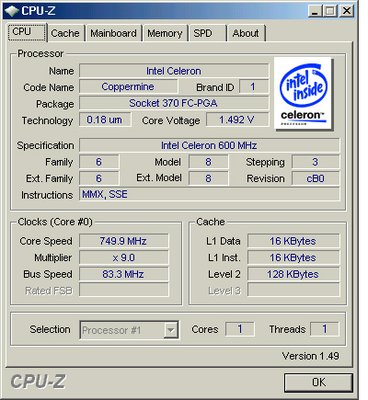

Mendocino, Coppermine (OPs 700 Mhz) and Core based ones were brilliant perf/$ after overclocking. Almost all Coppermine 66MHz fsb ones could be forced to run at or close to 100MHz equaling Duron clock for clock in games.
It seems hardly fair to judge midrange Celerons only for their 'gaming performance'. The 600Mhz Celeron that I used for the benchmarking earlier in this thread works at standard 1.5 volt and runs at fsb 83 without overvolting. For what it was meant to be and how it was meant be used it was possibly indeed bordering on 'brilliant'.
The attachment Celly600.jpg is no longer available
