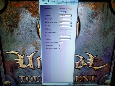

I'm not sure if it was always like this or not - can't remember from the last time I ran this machine.

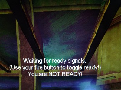

I noticed when I was testing UT99 in SLI mode. I set the resolution to 1024x768 initially and noticed how horrible the game looked. On closer inspection it seems there are 2 issues:

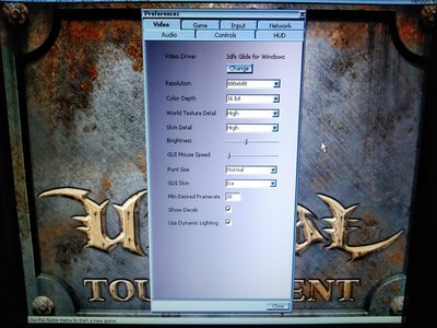

1) The colour depth seems to have dropped off a cliff (8 bit or less?). There is severe colour banding even on the UT desktop/menu screen and in game as well (is the menu rendered as a 3D component?). When I switch back to 800x600, the colour is nice and even again and believably 16 bit.
2) There are some sort of lines that make the scene look like it's being viewed through shutters. The spacing isn't that bad but it's noticeable. It's definitely worse than in 800x600 so it's not what I would consider "normal SLI scanlines" or any such phenomenon. These lines are more exaggerated.
Combined, switching to 1024 makes for a muddy, grainy, dim looking scene that is far uglier than 800x600.
After checking with other games, it seems all are affected equally so it must be a card thing. Might there be a setting I could change to fix this? I'm hoping it's not hardware. After all, the lower resolutions look just fine.

1) Voodoo2 disables dithering for 1024x768. There's never dac filtering for this mode either (especially with SLI as that should disable it altogether). The same applies to single V2s running a z-less 1024x768 allowed by certain games.
2) Yep, scanline artifacts are a given wiht how SLI works. This is normal.

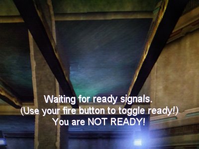

Thanks for the links. Actually the pictures in that thread are helpful because my UT menu screen looks WAY worse than that. I mean the colour banding is very bad compared to that.

Setting SSTV2_VIDEO_FILTER_DISABLE to 0 was what did it. 1024 must have been toggling it on so by turning it off all the colour banding goes away and it looks good again. I also tried AA, which didn't hurt anything and 24BPP caused artifacts as warned above.
To make these changes you have to go into the windows registry under local machine > Software > 3dfx interactive > Glide and add the above environment variable. Since the variable won't exist at that point, it means the card can change the setting itself, which it seems inclined to do when you go from 800 to 1024. Adding this variable prevents that by permanently disabling it.
