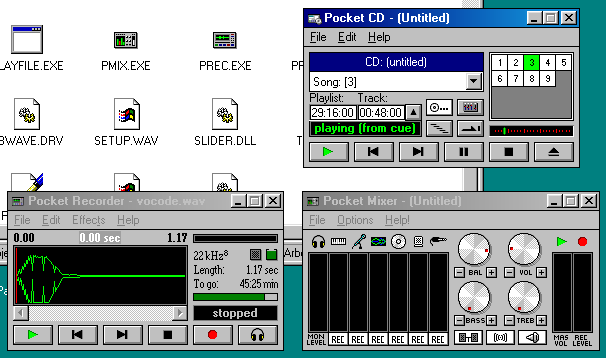

Reply 10 of 23, by Intel486dx33
Does anyone know where one can download these MV Pocket programs. Supposably they came with the Memphis install diskettes.
Reply 11 of 23, by Jo22
^I'm not 100% sure, but I believe these programs are also contained in programs.lzh on the PAS16 setup disks - vogonsdrivers should have them.
