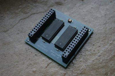

This board has an Intel 430HX chipset which is a good one for classic Pentiums but not many boards of this age will support Pentium MMX. I see no sign of this on this particular board, there should be an option to set the lower voltage it needs. The multiplier table shows this too but it's not a 100% sure way to tell as the MMX simply remaps 1.5x to 3.5x so it can run at 233MHz at 1.5x setting. So you should look for something saying "2.8V" or "2.9V" - something I can't see in these photos.
On the other hand, with adequate cooling a Pentium MMX should survive running at 3.3V - but I really don't know if it would work in this particular board. It's definitely off-spec, though.
As for the VRAM upgrade it's possible but I'm not sure it's worth hunting down the module it needs.
It should look something like this one I have in my "strange memories" box:
The attachment strange.jpg is no longer available
