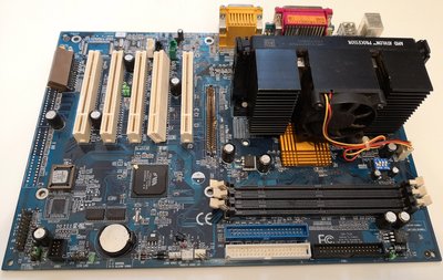

Sometimes it just works, so I think it's worth a shot. Next on the list for the 'ISA-implant' will be this battered GA-7VX Slot A motherboard that I got from the fleamarket, with the AGP, AMR and one of the PCI slots destroyed, and the ISA slot not fitted from factory. All the support components are already soldered, so I expect it to just work.

Look at the space in the top right of the picture above the first full length PCI slot. I'll bet you that is the space for the ISA controller chip. It looks like it was left out since the motherboard does not have the slot installed. ISA is completely different from PCI, so they won't use the same controller chip. Also, even if you were to source the chip, the BIOS most likely won't support it and you won't be able to use it. It probably won't break anything if you install a slot anyway unless you heat-damage the board, but it most likely will not work.

I don't think there really is such a thing as an ISA controller chip, and there is no such thing as a PC without an ISA bus. If it's IBM compatible, it's got an ISA bus with internal peripherals on it, even if there are no slots. On modern PC's (like the one in the picture 😉) all this functionality will be integrated on the chipset/southbridge.
If I had to guess, the spot with a nonexistent chip in the picture is probably for an integrated audio chip option, since it's sitting pretty close to where the mic/line/speaker outputs would probably be on the I/O shield.

Either way, looking online at other variants of this motherboard the missing chip is definitely supposed to be an on-board Soundblaster. And the VIA KX133 chipset on this board has the ISA-PCI bridge integrated on the VT82C686A southbridge.
All that being said, I would guess that, on this particular board at least, soldering a slot to it would probably work.

then you might be in luck! just solder the slot and see what happens I doubt anything can break by testing this assuming nothing is missing - worst case scenario the isa slot does not work 😀

This is for an optional Creative/Ensoniq ES1373 chip. The mobo makes use of south bridge integrated logic for audio with an external AC'97 chip.
The ISA slot is likely to work on this mobo if soldered properly.
