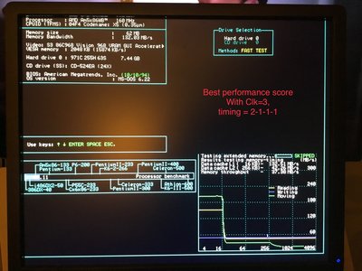

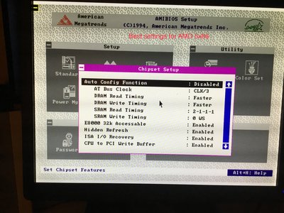

I was fooling around with the bios settings.
The motherboard PCChips 918i bios rev date 1994 does not officially support the AMD 5x86-133-P75.
and I was having ram and cache performance problems so I was fooling around with the timing settings and was able to get it to perform
better at ( Clk3 with timing=2-1-1-1 ) as it was using by default in auto settings ( Clk5 with timing=4-1-1-1 ).

Actually, now that I recall. It was benchmarking fine in DOS 2.66 using Philscomputerlab benchmark tools.
So I think I will put the AMD 5x86 back in and confirm a stable build.
Then I will reinstall Win95c because I think the original install has become corrupt and was causing the lockup.

Okay, I am back up and running with AMD 5x86 CPU.
Benchmarking and regression testing now to confirm best bios settings for a stable build.
So far so good.

Reply 7 of 9, by Disruptor
retardware wrote:
Lock up when accessing peripherals can also be caused by too-high ISA bus speed.
Try AT bus clock CLK/4 when testing whether the hardware has gone bad.
He has clocked the FSB at 40 MHz, so even CLK/4 is too much.
ISA Bus clock should be at 8 or 8.33 MHz.
Your 40/3 = 13.33 MHz has been very risky.
CLK/6 @ 50 MHz FSB
CLK/5 @ 40 MHz FSB
CLK/4 @ 33 MHz FSB
CLK/3 @ 25 MHz FSB
CLK/2.5 or CLK/3 @ 20 MHz FSB
CLK/2 @ 16 MHz FSB
Anything else overclocks the EISA or ISA bus.

So what “Clk” setting and timing do you recommend for a AMD 5x86-133-P75 overclocked to 160mhz. ?
Core v3.3
I have it set at 4x40mhz. = 160mhz.
So is a Clk/5 @ 40 MHz FSB with timing of 2-1-1-1
Is this okay ?
Reply 9 of 9, by Disruptor
CLK/5 is correct at 40 MHz FSB.
2-1-1-1 may work, but it is tight. You may have luck. Perhaps you need 1 write wait state. Be patient and don't draw conclusions too early.
Please report.
