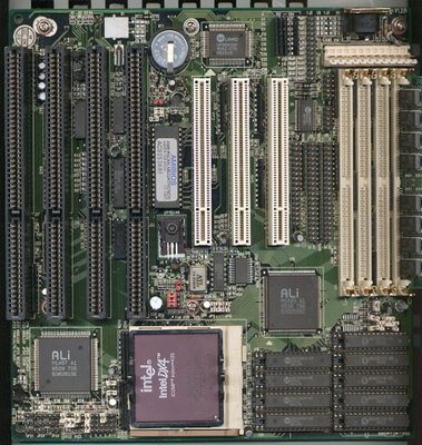

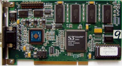

I would like to here of some recommendations for the best choice video card for an AMD 5x86-133-P75 overclocked to 160mhz. Currently I am using the Number9 video card with S3 vision 968 chip but if I can use something better what can it be ?
Motherboard - PCChips 918i socket-3 with ALI chipset
I have 3 PCI slots and 4 ISA slots.
300watt PSU.
64mb. EDO Ram 60ns
256kb motherboard cache
Win98b.
CF card 8gb Sandisk extreme.

Reply 1 of 11, by STX
Having too many good options is a good problem to have. Personally, I'd try the Voodoo3 if I were you.

Reply 4 of 11, by elianda
I would stay with the S3 Vision968. It has very good VESA support and mode compatibility.

Reply 6 of 11, by chinny22
Problem is even a 5x86 struggles at 3D so really you'll be focusing on 2D
You could try out some of those early 3d API's that didn't kick off
S3 Virge S3D is the most interesting as it has the most games, I have this in my 5x86, the games run but struggle a bit.
