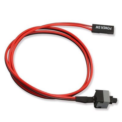

exist something like ATX power button adapter to AT case power button? Because ATX has usually just simple switch like this:
The attachment ATX-switch.jpg is no longer available

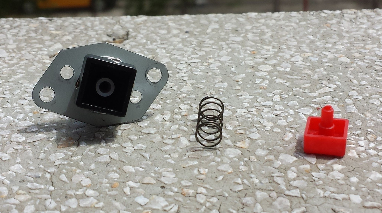

But AT had some special 2 holes for hold special metal plate:
The attachment AT-PowerSwitch.jpg is no longer available

Reply 2 of 7, by PARKE
For an AT case power button like in the image that you posted you can use one of these:
https://www.ebay.com/itm/1x-Computer-Momentar … 2-/252661219710
For the display you can draw 5v power from the red and black wires in any molex connector, or you can for example use the two pins on the motherboard control that feed the power led.

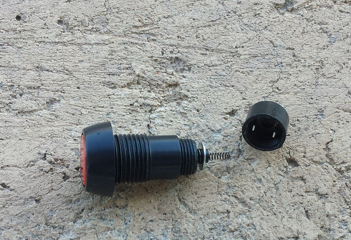

Hello, I'm building a Retro PC using an ATX PSU with a Baby AT motherboard. I have an adapter and also a power switch but want some advice on how to use them together. This reddit post guides me in the right direction:
https://www.reddit.com/r/retrocomputing/comme … r_supply_to_at/
I attached an image of the adapater and switch I have. My question is, would I have to cut off the black and green wires on both items and tie the exposed copper together(green to green, black to black) and wrap up the wires separately with electrical tape?
Or do I solder the the switches wires to the adapters metal quick disconnect tips?
There is no place on the switch to attach the quick disconnects.
Reply 7 of 7, by lu_source
Someone was able to help me get this working. There was a button that game with the switch and I connected the adapter directly to it like this.
Black Cable from PSU adapter to the C(Common) connector on the button.
Green cable of PSU adapter going into NO connector on the button.
Doing that allowed me to power the motherboard.
