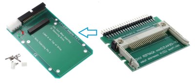

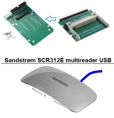

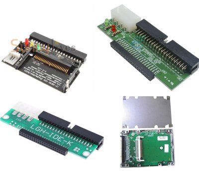

1.) "Start MS-DOS from floppy disk"🙁 Do you mean DOS 6.22 installation disk nr:#1,2 or 3 ? )
2.) "Find-ata or IDEinfo-software". So I plug the drive to another computer win98 ?
Western Digital SiliconDrive: CF cards have "auto detection" to automatically change to fixed disk or removable device.
I have ordered all kinds of adapters: see photos.
- Which one do you use ?
The size 512mb could be also the fault. (Dos6.22 installs but it won't boot.)

- I can't read the actual CF-card anymore with my modern PC's separate external USB 3.0-multireader. Now it wants to format it and can't access it. Previously I was able to see the files normally.
