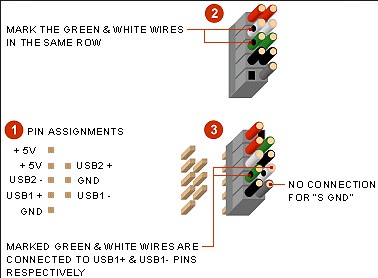

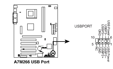

hello i just have a quick Question about using a pci USB 2.0 card with internal usb 2.0 type a Jack on the pci card itself. i tried to buy a adapter to convert the pin connector for my front usb jacks that came with the case to a usb 2.0 type a plug for the pci usb 2.0 card but the device i tried to plug in did not show up in windows i tried a usb flash drive that was it from what i remember and the os i was using is windows 98 se and i had the USB flash driver installed my i have a usb 2.0 hub i installed that a got from ebay and that works fine in that usb slot on the pci card. if you need the model of the pci usb card or and other info let me know. thanks for the help and reading this 😀
Reply 1 of 17, by Intel486dx33
You need to check the USB cable pin correlation. Some motherboard are different.
Check your manual and google it.
I had this same problem before.
I just had to switch the wires around on the cable and it worked.

Reply 2 of 17, by Demonslayer2103
Intel486dx33 wrote:
You need to check the USB cable pin correlation. Some motherboard are different. Check your manual and google it. I had this sam […]
im talking about using a my front panel usb on a pci card since my motherboard doesn't have onboard usb header for the front panel to work

Reply 4 of 17, by cde
I would recommend taking a type A male cable, cut it and solder the connections to male 2.54mm headers. Make sure D+ and D- stay the same length.

Reply 12 of 17, by cde
Demonslayer2103 wrote:
Although I did not try this hack yet, I did a similar one to get the front panel AC'97 connected to two audio cards (one ES1868F and one Audigy 2 ZS).
this is what i used to to convert the connector is this what you mean
https://www.ebay.com/itm/332407752005
Correct I was thinking exactly of that! Had no idea this existed, now I probably will buy a couple 😀
Reply 13 of 17, by cde
PC Hoarder Patrol wrote:
As far as the OPs usb problems, I've used those types of adapters numerous times without issue - am wondering if the front panel connectors are properly matched to the pinouts on the adapter,
My KT7A has a USB 1.1 header on the motherboard that has a different pinout than the classic USB 2.0 header that came to replace it.
Basically GND and Vcc are switched, and also the key is swapped one place (fortunately).
So what I did was to turn the connector 180 degrees and shifting it by one. This connects Vcc with Vcc and GND with GND.
However D+ and D- are now inverted. Nonetheless this hack appears to work (USB devices get recognized). Perhaps some kind of automatic D+/D- swapping exists, like what you seen in modern gigabit ethernet with straight and crossover cables?
Reply 14 of 17, by dr_st
Heh; this kind of crap was why some cases had USB front panel headers with all the pins separated into individual wires.

Reply 17 of 17, by Matth79
If the port works directly, then it's the cable conversion that's the issue, looks like the cable does a "normal" of +5, data pair, 0V and probably screen ground - the 5th pin if used tends to be either screen ground or overcurrent.
One A to header connector will only liven one of the front ports
