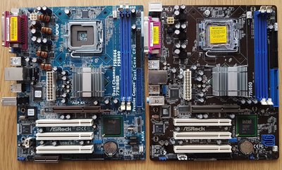

Asrock 775i65G R3.0 vs. R2.03
Asrock 775i65G R2.03 is very nice board, with highest bios, board support Pentium Dual Core 45nm (Pentium E5800) and works similar to R3.0.

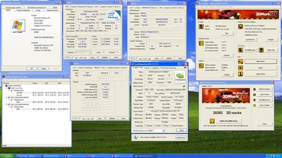

Board: Asrock 775i65G R3.03
Processor: Pentium E5800 3.2 GHz
Memory: Kingston KHX3200ULK2/512 (2x256 MB) 2-2-2-5
Graphics Card: Geforce 5900 XT AGP 400/350 MHz
Windows XP SP3, Forceware 81.98
3DMark2001 SE: 20263

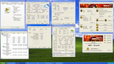

Processor: Pentium E5800 3.2 GHz@3.7 GHz
Memory: Kingston KHX3200ULK2/512 (2x256 MB) 200@230 MHz 2-3-3-6
3DMark2001 SE: 20817

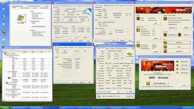

Board: Asrock 775i65G R2.03
3DMark2001 SE: 20057

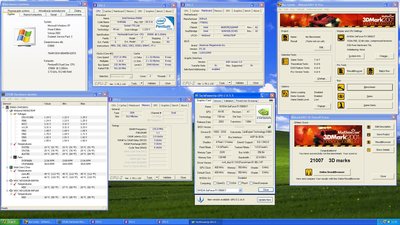

Memory: Kingston KHX3200ULK2/512 (2x256 MB) 200@233 MHz 2-3-3-6
3DMark2001 SE: 21007

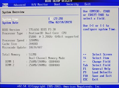

Bios 3.3 Asrock 775i65G R2.03 with Pentium Dual Core E5800.

Bravo on the hardware for this board. High multiplier FSB800 beats the bad "FSB1066” implementation hack and 45nm Pentium dual core generate little heat on top of that which pairs nicely with a lower clocked NV35. 512MB low latency RAM at 1:1 ratio makes me hope this system was put together for Win98.
With an SB Live (maybe Audigy 2) and SATA SSD you have an optimum Win98 setup. A better GPU isn't going to get you anything for games which only run on Win98 or below and I've still to see any compatibility issues with XP games on sandy/ivy bridge and very recent Geforce cards.
Screw period correct; I wanted a faster system back then. I choose no dropped frames, super fast loading, fully compatible and quiet operation.

Having problem with r2.03 , bios P3.30 and E5800. Fans spin up, but it doesn't post. Put back Celeron 351, and it works. Memory modules are Patriot PSD1G400H.(Tried also with only one.)
Are you running r2.03/Woolfdale Pentium combo with regular Asrock bios or modded one?
