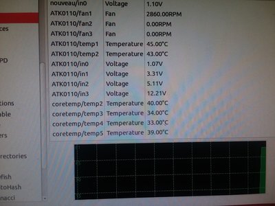

I was using the temperature reading in the BIOS, so I had no choice. I set up a flash drive with Ubuntu 18.04 and installed hardinfo on it, and I'm getting strange results that reflect what you've said for the most part.
1.52 MiB
535 views
The two middle temperatures stay at a solid 33c, unless load has been applied, but the other two seem to like to idle at nearly 10c higher, with the top core there staying at 39-40c most of the time, and the core at the very bottom doing the same. I'm not sure what this indicates, if anything, but I'm hoping that this will give more insight as to what's going on.

Reply 10 of 22, by jmarsh
Everything looks pretty normal.
As someone said earlier, it's basically two core2duos stuck together so the core temps will be paired. One pair of cores will always be hotter than the other.
Temps in the BIOS will likely be higher than expected because speedstep won't be active (to slow the CPU when idling).
Most importantly, idle temps are mostly irrelevant (as long as they're below 70/80). Worry about the temps when under load...

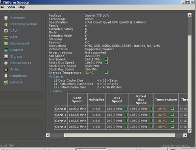

Reply 11 of 22, by PARKE
There is this little freeware program that shows a similar output:

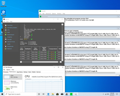

I put in an old 500GB SATA II HDD that I had laying around into the machine and installed Windows 10 from the same USB stick, just formatted and made using the USB maker tool. I installed Speccy and Prime95, and ran a generic stress test to see what it did with the Freezer 7 Pro. This is what I got:
254.34 KiB
384 views
At idle, it runs at roughly 42-48c. I ran the stress test for close to 5 minutes, and it hung around 55-58c, but one of the cores was a fair bit hotter than the others, even though the test I ran put stress equally across all of the cores. This one core remains hotter than the others throughout usage, and I don't believe I've ever seen a temperature discrepancy this large between different cores on a processor, even on other Core2Quad models.
At least the cooler was putting out sufficient amounts of heat this time, I could feel the hot air coming from the back of the case.

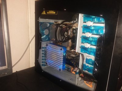

Speaking of such, here's a picture of it to give you guys an idea of the ventilation it has:
1.46 MiB
384 views
This case has a little fan controller built in, and you can adjust case fan speeds using it. While running these tests, I had the case fans (one in the side and one in the back, both are visible) running as fast as that little controller could push them.

Reply 18 of 22, by dr_st
athlon-power wrote:
I've now ascertained that I should probably dump the 'ol Freezer 7.
You are probably overreacting; as you saw from running more accurate tools, your temperatures are fine.

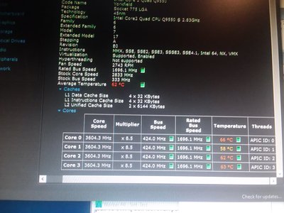

I may want to rescind my prior statements about this cooler. I decided to remount it with Arctic Silver MX-4, and this time, the cooler felt a whole lot more secure. I got cocky, and decided to overclock it to 3.6GHz, and these are the temperature results I got at full load:
1.61 MiB
312 views
These are essentially the same results I was getting before at stock speeds at full load. At 3.6GHz, this thing is keeping my processor somewhat cool at load. It occasionally heats up to an average of 62-63c, with the hottest core topping out at 66c, but for the most part it runs more like it is shown in this screenshot.
