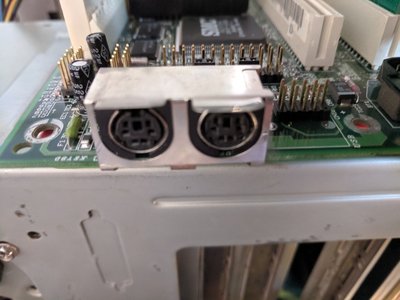

Hi,
Got today a good looking Acer M11A Socket 8 motherboard. All looks good, it does POST and get video signal, except the PS/2 keyboard is not detected. Keyboard works on another system from that era.
Tried USB keyboard with PS/2 adaptor - no joy either.
The motherboard has 2 PS/2 connectors, and none seems to work - none of the two keyboards are not detected.
144.12 KiB
175 views
Any ideas or suggestions what could be damaged, and how this can be fixed? is replacing the PS/2 sockets an option?

Reply 2 of 5, by vmr_
no leds blink at power up. That green fuse reads F1 3A / 125V. will test it with the multimeter for continuity - unless I have to desolder it to verify it.
wondering where to look for a replacement - any suggestions?

Reply 3 of 5, by vmr_
yup - continuity test fails on that fuse.
Wondering if the fuse is a quick blow one, or a slow blow? Links from Farnell below:
https://ie.farnell.com/multicomp/mcpfp-3a-125 … w-3a/dp/1566032
https://uk.farnell.com/multicomp/mcpsp-3a-125 … w-3a/dp/1566048

Reply 5 of 5, by vmr_
@luckybob - what USB?
did not try with a PCI-to-USB card adapter, but that is my next option - if PS/2 connector keeps failing.
