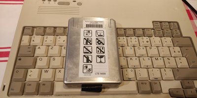

I've had this nice little 486 laptop with a 486DX2-40MHz and 20MB of RAM since few month, but I was never able to use it because it was missing the HDD caddy and the floppy disk drive is dead. Recently, I stumbled onto a nearly NOS HDD for the LTE 5000 (which uses the same caddy)

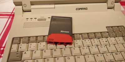

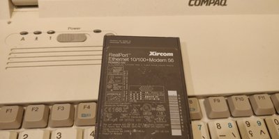

Since the floppy drive is dead, there is no easy way to put data on this laptop (the way I did was to use another 90's laptop and transfert with floppy disks ... That's not very fun to do), so I thought that maybe I can use a PCMCIA ethernet card.
Like this one perhaps ? (By the way, I know it works, I've been using it for a long time in my pentium laptops)

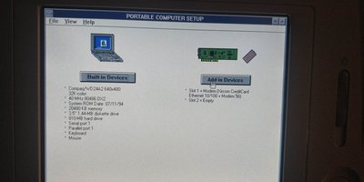

The computer boots normally, then when some DOS driver for the PCMCIA starts, the computer makes a beep, meaning the card gets detected I think, and the BIOS setup in Windows (yeah compaq made the bios setup of that computer specifically for Windows) confirms it :

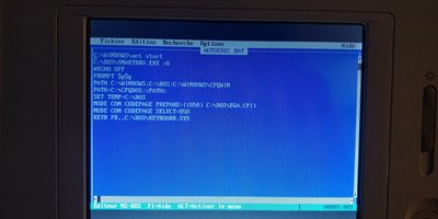

So after knowing the card was communicating properly with the computer, I tried to install these drivers http://vogonsdrivers.com/getfile.php?fileid=1348&menustate=0 as well as the 32 bit TCP IP network stack.
But there is a problem ; the computer crashes when starting on this step
1.63 MiB
220 views
This happens when C:\WINDOWS\NET START is executed in autoexec.bat (Also, this gets shown wether the card is actually in the computer or not)

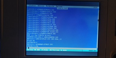

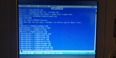

Here are my Config.sys and autoexec.bat files

What could be the cause of this ? Wrong drivers ? Something off in the startup files ?
Can anyone help me ? 😁

Reply 5 of 6, by lolo799
Try the drivers for your exact card, available from https://socket3.wordpress.com/downloads/drivers/
or those https://downloadcenter.intel.com/en/download/3235
