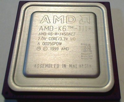

What CPU patches are available for AMD K6-3+ 450mhz. ?
Reply 1 of 16, by weldum
there are patches for a lot of different motherboards.
it's easier if you ask us if your motherboard supports them.

Reply 3 of 16, by weldum
http://web.inter.nl.net/hcc/J.Steunebrink/k6plus.htm
in that page there are modified bios for a lot of motherboards
the processor may work if certain conditions are meet
Selection for 2.0V or 2.1V CPU Core Voltage
100MHz Front Side Bus
K6-2+/III+ BIOS support
i think that both the fic and the soyo are compatible, depending on revision of the motherboard

Yes, I have updated the BIOS's already. And the CPU's are recognized correctly and working fine. I just want to know if there are any Win98se patches to make these CPU's perform better.
Reply 5 of 16, by weldum
there are patches for windows 95, because it fails to boot on k6-2 or newer processors
for 98 and newer supports the processor correctly, the extra features (integrated L2 cache) work well

Reply 10 of 16, by cyclone3d
Intel486dx33 wrote:
I should have been more clear on “patches” I was thinking operating system patches but BIOS updates are just as important. I jus […]
I should have been more clear on “patches” I was thinking operating system patches but BIOS updates are just as important. I just went with the AMD K6-3+ and SS7 motherboard because it’s versatility. With these SS7 motherboards you get allot of versatility ( APG, PCI, ISA, ATX, AT, 32-pin and 72-pin ram slots ).
Also the K6 can be made to run at 300mhz. To play some old DOS games.
I think this setup has the most versatility for playing old games that require a slow CPU speed and yet I can run at 500mhz also to play more modern games. And supports PC-133 ram.
This is just a versatile computer build for playing old DOS games. Yes, for a reliable productivity computer build I would have went with an Intel CPU. But these AMD Athlon CPU’s perform well too.
You can go even lower than 300 on a K6-III+. Just drop the bus speed down to 66Mhz. With a 2.5x multiplier, that would give you a speed of 165Mhz.
Edit... actually, you can only go down to 3x... so 198Mhz.
2x with setmul
Reply 12 of 16, by Intel486dx33
Do you physically have to change the jumpers or can you just do it with software.
By disabling cache in bios and setmul utility ?
Reply 13 of 16, by cyclone3d
rasz_pl wrote:
2x with setmul
Oh, nice. I didn't know that. So you can go down to 132Mhz.

Reply 14 of 16, by cyclone3d
Pretty sure you can only do that with jumpers as it is motherboard, not CPU controlled... and no Socket 7 boards had BIOS fsb controls.

Reply 15 of 16, by rasz_pl
mobile cpu, soft multiplier
https://youtu.be/RzpM3fj3Pbs?t=6m42s
