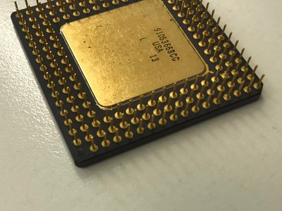

I got donated a bunch of CPUs. Along with a i386DX-20 with a soldered on pin that seems to be functional I got an i486 A80486DX-33 that is missing its S1 pin with nothing left in its place to solder a pin onto.
According to this spec sheet it is the A27 pin. I guess that means it's an address pin and is required to access RAM? I'm thinking this a critical pin, so the CPU wn't work without it, it is trash isn't it?

Reply 8 of 14, by appiah4
rasz_pl wrote:
can you make a picture? is there at least a stump in the spot?
there are conductive glues, would make really fragile connection, maybe glueing a small copper pad and sticking a pin into socket to form a friction joint when pressed could work
I havent seen ceramic 486 sliced in half, so no idea how the lead frame looks like internally, are those pins friction welded, glued?
Yeah sure, see the stump attached.

Reply 10 of 14, by appiah4
treeman wrote:
that pad has to go somwhere, is it possible to dig in a little with a sharp knife to try find the end and add solder?
This is advice I heard from elsewhere too, just scrape it until you find the copper, then solder on the pin there..
I don't have the pin either, though 🤣
Reply 11 of 14, by treeman
I have a overdrive cpu that a pin fell off, I used a wire of similar thickness and length and soldered it to the pad. It will only go in a socket once and most likely fall off when you take it out, so I put it permanently in another socket/bracket like this
it works just like original now, so you need to dig down for the connection, solder some new pin from a similar length and fatness material and put it in a new socket

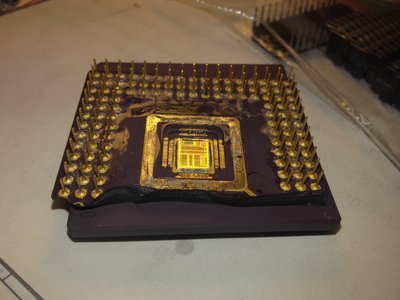

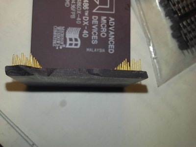

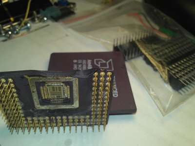

Reply 12 of 14, by SSTV2
Edge pads seem to be corroded and S17 pin looks like it's about to fall off. Perhaps there is a way of recreating pin connection by using conductive paint or glue, like rasz_pl stated, making it sort of "LGA" type of pad, but from the looks of it, it's probably not possible, as no metal wires are sticking out. I wonder what type of conductors were used to connect pins/pads with different layers in those ceramic CPUs.
Am5x86 133ADW guts:
1.69 MiB
754 views
1.55 MiB
754 views
1.78 MiB
754 views
Three layers can be seen, but no traces of metal.
Reply 13 of 14, by treeman
very very interesting, 3 layers I am guessing because 3 rows of pins so they are multilayer, looks magic no traces but the signal from the pins goes to the core. I wish I had a cpu to sacrifice because I am very curious now
Reply 14 of 14, by Tiido
There's no actual leadframe there from what I know, only sputtered gold. So there isn't anything to really solder onto. Conductive paint might be the only solution.
