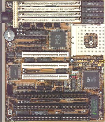

I finally got my Lucky star LS-486 motherboard working.
I currently have it with an Intel 486dx4-100 CPU.
But it also supports the AMD 5x86-133-P75 CPU.
What do you think ?
Which would be best for playing DOS games and which will down clock better to 25mhz or 33mhz ?
The LS-486 has 16mb , 60ns fast page ram
256kb , -15ns cache.
32-bit EIDE controller
PCI and ISA slots.

Reply 3 of 13, by brostenen
How about just buy an 486dx33 or 486sx25? They are still affordable enough to get these days.
Reply 4 of 13, by Intel486dx33
I would like the versatility of being able to run at a normanl speed of 100mhz or 133mhz and be able to downclock to 25mhz or 33mhz.
Is it possible ?
Which CPU is bests for this ?

Reply 6 of 13, by bakemono
How are you going to get down to 33MHz? Those CPUs don't have a 1x multiplier (unlike Cyrix 5x86 for instance). Unless your bus speed goes lower than 25, then the best you could do would be 50 or 75MHz and then disable the L1 cache.

Reply 8 of 13, by appiah4
You could use the Reset switch on the case connected to an appropriate jumper on the board to change CPU type from DX2 to DX, which would theoretically disable the internal multiplier and bring the CPU down to 33Mhz.

Then why do many boards have a DX/DX2 CPU type jumper?
The single multiplier pin on a 486 is ignored by most cpus
My AST Advantage 4/66d Cyrix had about 15 cpu jumpers and to move from a Cyrix to an AMD 5x86 I had to change them, I still ended up at 100mhz but at least it worked.
No idea what they all did, most 486 systems had voltage, a multiplier and one more jumper and that was it, they were all different

Incidentally, I was just going over the jumper settings for my Chicony CH-471A (rev.3) motherboard.
In many instances, you'll notice that the jumper settings for, say, an Intel 486DX-33 is the same as for an Intel 486DX2-66 and again for a 486DX-25 & a 486DX2-50.
I think motherboard manufacturers just listed each supported CPU's jumper settings separately to avoid users setting up those CPU's incorrectly.

Thanks All.
I have an IBM PS/1 with 486sx33 that was going to upgrade to 66mhz. But I think I will keep it at 33mhz now.
I am going to try out both of these CPU’s and see how low they will go.
I am going to use the “Setmul” program to disable L1 cache and use the turbo button function.
