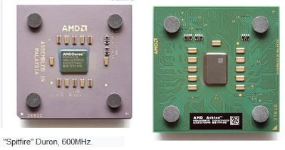

Reply 4 of 7, by user33331
Anyone remember which shim type is for which socket A processor ?
What fits AMD Duron Spitfire ?
In my luck Athlon XP-type propably does not fit.

Reply 6 of 7, by cyclone3d
If you have one that is the wrong type, you can just trim it with a file or dremel tool to make it clear all the surface mounted components and contacts. That's what I have done in the past.
And the shims aren't to lower the pressure.. they are to keep the heatsink from tipping on the die so you don't crush an edge of the die.

Reply 7 of 7, by lost77
I think the ones for Athlon XP are thinner because of a lower die-height. That should be fine though, it's the other way around that would cause problems.
As for cooling, any Socket A heatsink will be fine, even the small cheap aluminium ones.
You can lower the voltage a bit below 1.6v to make it run even cooler if you want. I had a 650Mhz running at 1.55v at one time.
A copper heatsink would be able to cool it with a low speed fan, would be a more quiet option if you had one laying around.
