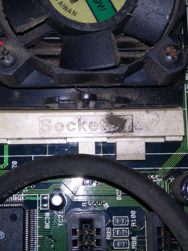

The writing says 'Socket 7'.

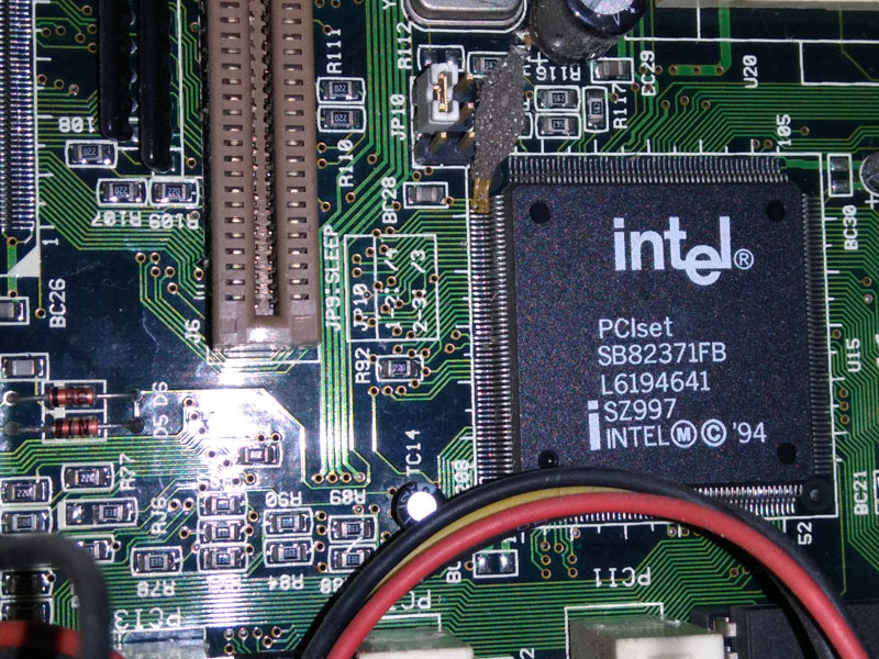

The motherboard layout matches a PC Chips MC507 photo I found on ebay. It also appears to be Socket 7 instead of Socket 5, so it should be able to accept Pentium CPU faster than 133 MHz but feel free to correct me if I'm wrong.
There are two large, square shaped chips on the motherboard. I'm not sure if which one is Northbridge and Southbridge, let alone whether I should call them Northbridge/Southbridge or simply memory controller hub (MCH). Nonetheless, the first chip --the one closer to the CPU-- reads as follows:
PCIset
SB82371FB
L6194641
SZ997
Intel (M) (C) '94
The first motherboard chip, the one closer to the CPU.
The second chip --the one closer to the RAM slots-- reads as follows:
PCIset
SB82437FX66
L6194762
SZ999
Intel (M) (C) '94
The second motherboard chip, the one closer to the RAM slots.

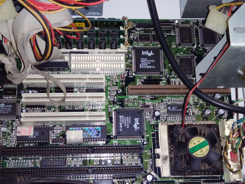

There is also another square-shaped chip on the behind the PCI slots (if you consider the CPU socket to be the front of the motherboard), which reads as follows:
UMC
UM8663BF
9617-BXS
ZM3655
Another square-shaped chip behind the PCI slots.

(1) is this motherboard really a PC Chips M506 or M507? Is it really a Socket 7 motherboard? Or is it actually a Socket 5? PC Chips M506/M507 is my best guess so far, but please correct me if I'm wrong. Warnings are welcome.

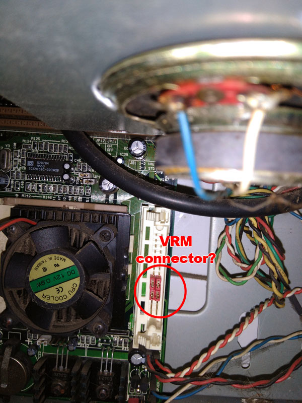

(5) Can I put Pentium MMX CPU on this board? I remember you need a voltage regulator module (VRM) to use MMX CPU on an Intel 430FX motherboard, but this board seems to have VRM connector slot (labelled as CN7 on the manual). Where could I find such VRM? Tried ebay but to no avail.
What appeared to be VRM connector --labelled as CN7 on the manual.

For the possible installation of the Pentium MMX you must first understand the exact model of the MB (including the version), this information can be found by starting a program like CPU-Z or CPUID (also goes well with the P100) in the motherboard section.
But from what I remember, maybe you need a special VRM card, to support Pentium MMX, alternatively there would be the adapter for Socket5 / 7 is explained here what you can do:
No idea on the PC Chips model number (did you check the PC Chips Lottery?) but it is definitely So7 as you can select 2.5x and 3x multipliers. That means the second multiplier pin (the biggest difference between So5 and So7) is supported.

(3) will putting a 512 KB cache on a stick (COASt) on the motherboard's SL1 slot help improve frame rate in non-accelerated, texture mapped 640x480 3D games? And where to find such COASt? Is this one compatible with my motherboard?
The board already seems to have 256kB (?) PLB onboard, unless PC Chips was up to its usual fake cache stuff. If the onboard stuff is fake, adding real cache will improve performance a lot. If it's real, upgrading 256kB to 512kB isn't going to make a massive difference, but certainly won't hurt. As for where to find... the usual places for old PC stuff, which differ from location to location, and I'm afraid any NW-European tips I could give would be utterly irrelevant in your neck of the woods.
Boards with VRM connectors were all the rage around 1996 - a simple way to sell old stuff while promising an upgrade path that in reality was almost never used, as by the time your non-MMX CPU needed replacing you were probably already in Celeron/K6-2 period if not P3/Athlon and that VRM wasn't going to help you there (nor would it have been availalble). I can't recall ever having seen a VRM for a regular AT board like this. They probably do exist, but no clue as to where to find one. Not sure about BIOS support either.
I'd agree with PC@LIVE that a socket converter a la Kingston/Evergreen would be a more realistic option - but given that they tend to cost more than a whole So7 split voltage board, only go down that path if you really, really want to keep this specific motherboard.

VRMs were more common in PPRO systems, most folks end up having to build one if they want one, they were quite rare.
Best bet would be one of the overdrive sockets with its own vrm onboard

Wouldn’t an overdrive cpu run at typical P-100 voltages? I’d bet an mmx overdrive would work.
Reply 6 of 71, by cyclone3d
The overdrive CPUs have onboard voltage regulation. So externally, they run at the regular old Pentium Voltages, but then the onboard regulation circuit changes it to the needed voltage for the CPU.

According to webhq, it supports P55C (pentium mmx) with VRM http://www.elhvb.com/webhq/models/pcchips/m507.htm

The cache looks definitely fake as I can (hardly though) read "WRITE BACK" on them which screams for pcchips' fake cache

I found a note on the COAST module in my PC, it's a 512KB module and it says "RAM REALTEK", has soldered 4 HY534256S-70 chips
I don't know if this info can be useful, but the suspect 256KB on-board cache is fake.

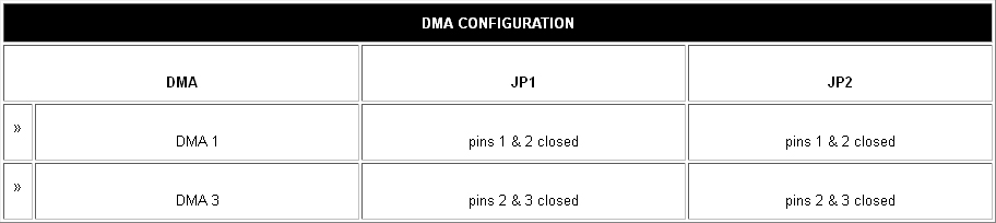

And what does DMA configuration mean on the manual? Obviously it enables us to select between DMA 1 and DMA 3, but for what?
Selecting between DMA 1 and DMA 3, but for what purpose?
DMA for parallel port ECP mode. Defauly is 3. Only relevant if you set it to ECP. If you are doing serious stuff on LPT (ZIP drive, NIC, etc) you would want ECP, otherwise, just set it to standard or bi-directional so it doesn't eat that DMA you might need for other things.

Reply 17 of 71, by PC@LIVE
On this site I found some important info on the K6-233 with Vcore 3.2V or 3.3V:
http://www.amd-k6.com/cpu-specs/
What matters is the Watts, because the linear regulators warm up proportionately.
In practice taking as an example the K6-233 (VCore 3.3V) and a K6-233 for laptop (VCore 2.1V), we note that the maximum Watts drop from over 30 to 9 and consequently the VRM should give off little heat.
So if it is not possible to have a Dual-Voltage VRM, I do not recommend for the K6 frequencies above 200MHz because the higher Watt demand, over time can create problems for the MB (also taking care of and improving the cooling).
I remember that there are CPUs like the IDT Winchip C6 that reach 240MHz, they are CPUs with a lower consumption, so they might not create problems, at the limit the old BIOS recognize them at startup mistakenly as 80486DX66, but if it starts it should work.
Of course using a CPU adapter with VRM on board (like evergreen or upgradeware), you can install a K6-2-400 or even a K6-3-400, setting FSB 66 and multi 2X (which the CXT interprets as 6X).
In the PCs of my collection in MB SKT7 with single voltage, in one I have on an Intel Pentium classic i200 (200MHz), and in another one Pentium Overdrive 166MMX (which has the dual voltage VRM integrated in the CPU), I also have various CPUs which I tried like the AMD K5-166 and the IDT Winchip C6 200.
