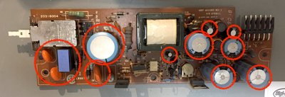

Reply 14 of 15, by SirNickity
I replace all of them, big asterisk. As well as the rectangular film cap you usually find at the AC input, and the X/Y ceramic disc caps. I don't usually bother replacing the ceramics sprinkled throughout the circuit unless they look dodgy. If it's exposed and not a nightmare to replace, I'll do the filter caps on the AC inlet itself -- where applicable. If the inlet is an integrated can with the caps inside, I'll let it slide -- it's probably a little obsessive to worry about those.
Now here's the confessional part. I have a few supplies that use just a crap ton of 0.1 to 10uF electrolytics. The IBM PS/2 supply was one of those. I didn't get in there and replace ALL of them, because some were on vertical boards I probably would have had to remove to get access to them all. The little ones don't usually fail, at least not on supplies where the bigger ones are in reasonably good shape still -- indicating quality parts and good engineering margins. If they're relatively easy to replace, I will, just because why not -- if I'm already in there anyway, might as well get it done.
Here's the "before" reference shot from the Tandy 1000 RL HD PSU I did this last weekend. Circled parts are the ones I replaced. The inlet was in a can.
357.36 KiB
420 views
Reply 15 of 15, by gdjacobs
Caps on the primary side are usually not a failure point anyway. For designs that don't have it by default, a filter can is a great retrofit that's really easy to implement. Small bypass caps, likewise, don't usually see much ripple and hence don't usually fail.
Your priority for replacement should always be the output pie filters and any buck converters on the motherboard. They always have large amplitude/high frequency ripple in the face.
