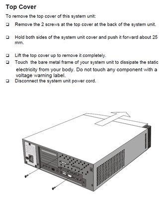

I haven't opened a case like this for many years, I remember it slides out forward somehow and that there was a trick to it but not before I broke the clips on my very first one, I would like to keep this one in 1 piece. Google wasn't too much help with this particular model, anybody with a similar or same model can give me a tip?

Reply 2 of 3, by PC Hoarder Patrol
Extract from the maintenance manual
122.52 KiB
154 views
http://ps-2.kev009.com/pccbbs/aptiva/2165hmm.pdf
