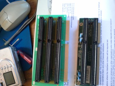

Unsure about a cable. But the ISA bus is well documented so it is possible. Quite a while ago I aquired an Ollivetti slimline system. When I opened it it up it had a nice 486 VLB mobo, a waste really with a riser that had 5 ISA slots. Three on one side two on the other. Also had a very small form factor Amstrad system in had a riser with two ISA slots.

You can buy pre-made PCI riser cables on eBay.
For ISA riser cables, it is a simple 1-1 cable so pretty easy to do as well.
You just need to come up with the male part... you could always use a sacrificial ISA card for the male part.
Or you can order some that somebody else already designed:
