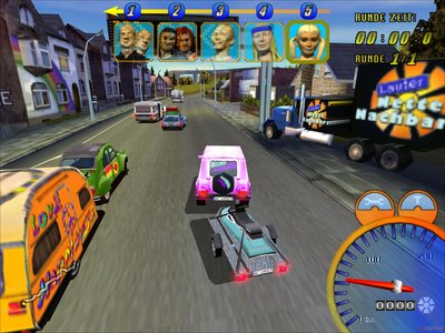

Works fine here:
575.03 KiB
945 views
Which I know isn't very helpful. FMVs didn't work, but that wasn't your problem.
