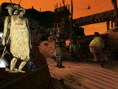

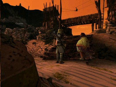

However, I still have some issues with 'Odyssey'. Namely, the background 'plates' for dialogue topics are not displayed with dgVoodoo. I think I have tried all the possible settings... Maybe someone could help please?
Here is how it should look like (the screenshot is taken with the game running on built-in Intel graphics):

And here is how it looks with DgVoodoo:

Reply 1 of 4, by Dege
I was aware of this issue. This comes from the combination of a certain limitation of dgVoodoo and the bad api driving of the game.
Anyway, now I re-patched the executable (Odyssey) and uploaded to my site.
Plz re-download it from the Patches section.
