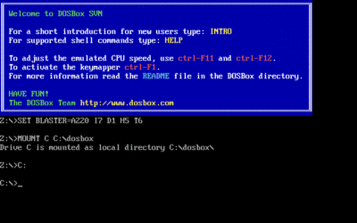

Reply 2 of 4, by Grunt
Ok, so answer is CALLBACK_Idle();. Now it is not exactly how do I remember it, it's even better:
file.php?id=65586&mode=view
It is perfect. Thanks a lot.
    144.82 KiB
    969 views

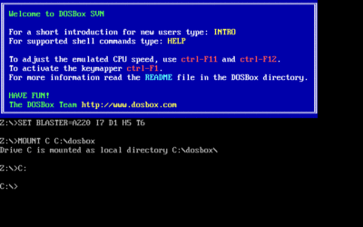

Reply 4 of 4, by Grunt
Just a random number of calls for given cycle speed:
static inline void modify_cycles(Bits value) {
int i;
for (i=0;i<80;i++)
CALLBACK_Idle();
  • i<10 - too little
  • i<100 - too much
  • i between 40 and 80 - just fine for me.
Only as I said, some of the games uses either case 0x3f: /* READ Read from file or device */ or case 0x40: /* WRITE Write to file or device */ while writing text on screen or somehow else end up in modify_cycles() and they shouldn't. Vanilla DOOM for example uses direct writing on screen and works just fine (modify_cycle() is used only for real disk I/O - notice the flickering floppy disk):
file.php?mode=view&id=65655
There is no reason to require some milliseconds anyway. CALLBACK_Idle() stalls execution for pretty long to require accuracy in order of milliseconds.
