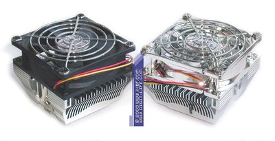

Cooler - wise - for a XP 2000+, anything will do really. I generally go for larger copper core coolers with 80mm fans, and replace the noisy high rpm fans they come with with better, modern quiet fans from thermalright or noctua.

Socket3 wrote:
noctua
+1, when looks dont matter, I always get noctuas, they are very quiet at lower RPM and reliable over long term, well worth their cost. Does not matter if you are getting a CPU/GPU/AIO cooler, the "stock" fans almost always suck.
